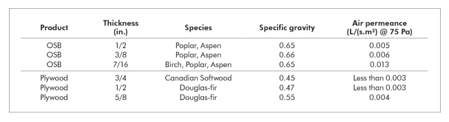

According to air permeance data from an ASHRAE-sponsored research project completed in 2002 by National Research Council (NRC) Canada, measurements for six tested wood structural panel products were below the threshold of 0.02 L/(s.m2) at 75 Pa for an air barrier material. Specifically, it found the following:
In a related project, NRC measured the air permeance values for North American plywood and OSB and found both to be “very air-tight materials.” Specifically, the six plywood products with thicknesses from 3/8 inch to 1/2 inch had air permeance between 0.00013 and 0.010 L/(s.m2) at 75 Pa, and the six OSB products with thicknesses from 3/8 inch to 15/32 inch had air permeance between 0.00066 and 0.014 L/(s.m2) at 75 Pa.

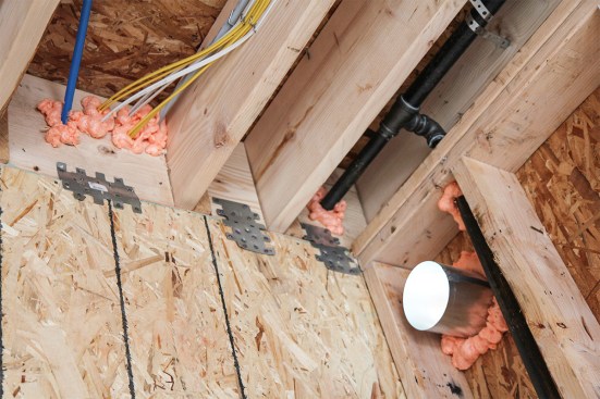

While wood structural panels meet the requirements for air barrier materials, they are not fully air impermeable—air will move through the WSPs under pressure just as it will through gypsum board or another other recognized air barrier material. This reinforces that airflow control is not about a single material but an assemblage of materials that make up an air barrier system.
Wood structural panels are excellent air barrier materials that are rigid and durable, two key characteristics to consider when choosing a material to be part of a continuous air barrier system. When using these materials, designers or builders must choose an appropriate method for sealing openings and panel joints. Contact the joint sealant or tape manufacturer for information on how their product works with wood structural panel substrates.

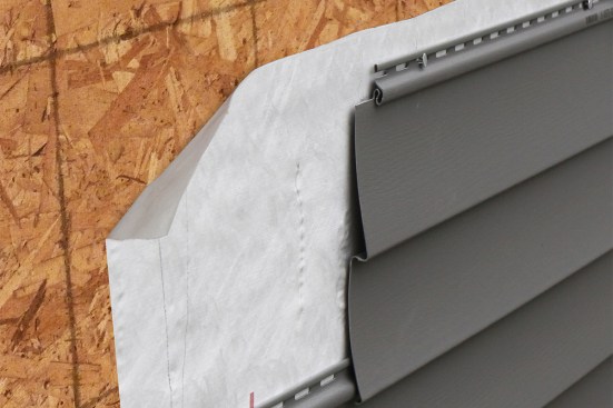

In addition, do not confuse an air barrier with a water-resistive barrier, which is required over wood structural panel wall sheathing. While properly sealed wood structural panels can serve as a standalone wall air barrier assembly, many builders combine the water-resistive barrier with continuous wood structural panel wall sheathing to serve as a combined air barrier and water-resistive barrier system.
