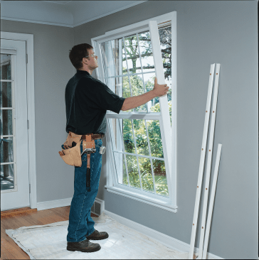

1. Drafty or leaky windows. Windows that no longer keep the elements out may indicate it’s time for a replacement. But often the fix is as simple as replacing outdated or worn out weatherstripping. Rather than a complete window replacement, new, more UV-resistant weather stripping can make an old window perform like new. But there may be times when replacement is the only option. Deteriorated sashes, visible water damage and warping are all signs that a replacement is in order.
2. Inefficient glass. Whether to save money or to save the planet, today’s homeowners want to be as energy efficient as possible. So when energy bills start rising, they may think their older windows need to be replaced. But many windows can simply be re-sashed or have new IG units installed in the existing sash.

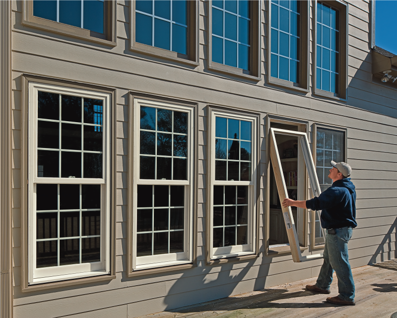

4. Fogging between panes. In contrast to condensation, fogging that forms between the glazing in an IG unit can’t be wiped away and is a sign of seal failure. In the case of seal failure, a simple sash replacement can address the issue while still maintaining the window frame, thus saving significantly in cost and time. Most manufacturers warranty their windows for this failure.
