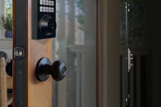

That’s why Kendall and the product engineering team at Endura made universal handset compatibility a central focus of the company’s new PanoLock+ Multi-Point Lock set. Today the patented lock set works with more than 1,300 hardware styles (and counting) from Schlage, Kwikset, Gatehouse, Baldwin, Brinks, and Defiant. That includes electronic lock sets, as well.
