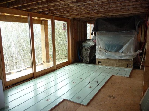

  6. What About Oversized Rooms? In-floor heating does have its limits. A great room or a room with big windows may be beyond the capabilities of an in-floor system alone. “We may have to add secondary heat, such as a radiator, panel rad, or a trench heater. But another great option is to install Warmboard panels in the walls.” he advises.
