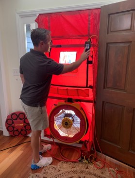

Image of man using tester device.

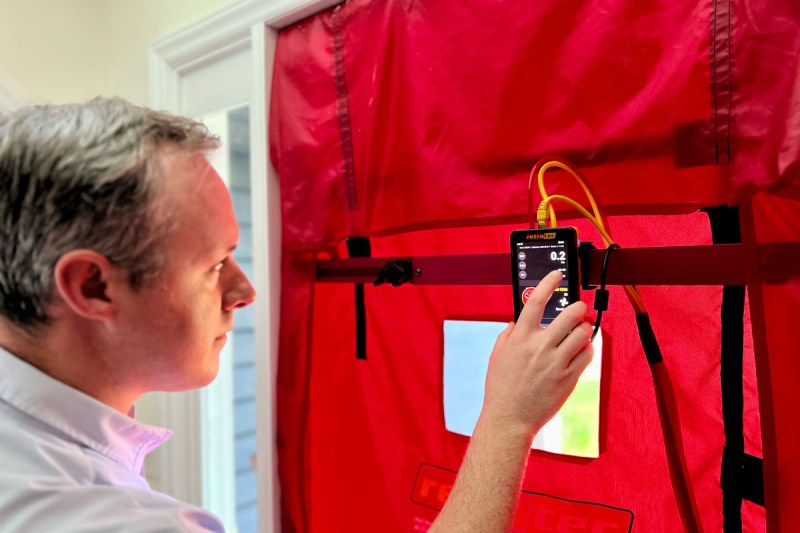

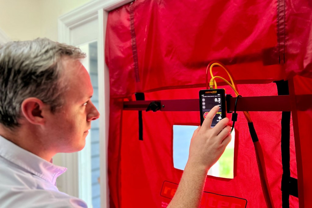

An airtight envelope has many key benefits including better comfort, lower energy use, cleaner indoor air, and better humidity control. Not only does this allow the house to perform better, it also makes it last longer. To ensure the home will be properly sealed, builders are now using the blower door test as a method of quality control throughout the build. A blower door consists of a calibrated fan, door panel, and a high-resolution manometer to bring the whole house to a desired test pressure. Houses are typically tested to 50 Pa of pressure. This can be positive or negative depending on which way the fan is facing. Most testers choose to test to -50 Pa to keep dampers from blowing open on bath and kitchen exhaust fans.

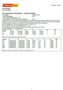

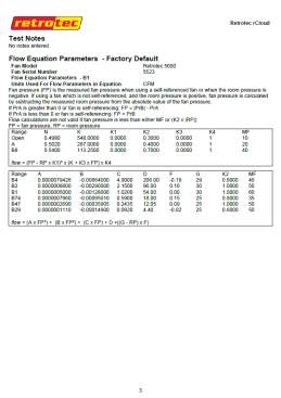

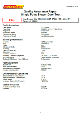

Below are two reports from the same house. The first report is the first test at the framing stage. The second one is the next test after the envelope was sealed more once leaks were located. The goal was to get the house under 1 ACH50. We can see this was achieved when it was tested the second time. In this scenario, the builder would want to test a couple of more times to make sure they are still under 1 ACH50 as the build continues. A good time to test is after all mechanical, electrical, and plumbing penetrations are made and once again at the final stage of construction.

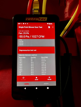

Image of rCloud on DM32X manometer
Both tests were conducted using rCloud on Retrotec’s new DM32X manometer, which is built on an Android platform. This allows Retrotec to place apps straight onto the manometer without any need to connect a phone or tablet. This frees up wireless devices to be used for other tasks. rCloud tests conducted on the DM32X can be run offline, saved locally on the manometer, and uploaded to the cloud later when there is an available Wi-Fi connection. This makes testing faster, prevents connectivity issues, and saves all tests in one place.
