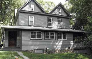

Clearly, we wouldn't be able to comfortably accommodate all these uses unless we significantly expanded the 200-square-foot room. In keeping with the homeowners' wishes, we looked to the yard — rather than adjacent rooms — for the extra space. By extending the house's front elevation outward by 8 feet, we were able to gain some 250 square feet. We tied the new exterior wall into an existing porch roof that wrapped around the rest of the house and installed three pairs of double-hungs; the new windows vastly improve the exterior elevation and bring ample light and views into the remodeled space.

Sheltered by deep eaves and punctuated by three pairs of double-hungs, the new exterior wall adds depth and symmetry to a previously drab elevation.

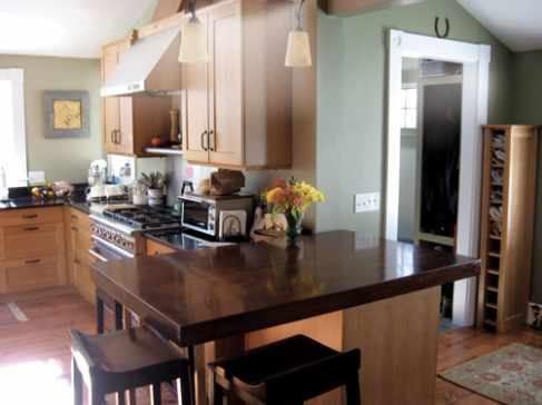

Between the cooking area and a beverage center — a mahogany breakfast bar with a recycling center tucked underneath.

At the same time, we didn't shy from giving the new space its own toned-down contemporary look. Though made of mahogany — a common material in the old parts of the house — the gleaming breakfast bar is unmistakably modern, as are the black granite counters. Simple cherry cabinetry, unobtrusive (but high-end) stainless appliances, and a combination of recessed lights, undercabinet fixtures, and pendants reinforce the kitchen's melding of traditional and contemporary elements.
