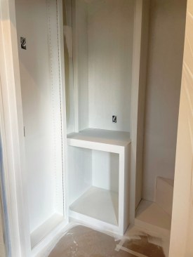

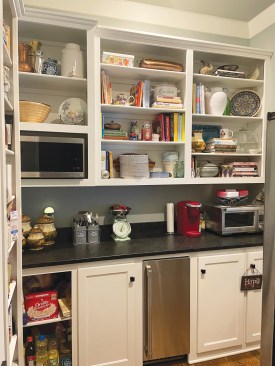

Every pantry I build has at least one section of 24-inch-deep shelves that are 36 inches tall with a fixed countertop. I tell clients that this countertop is a great place to sit bags of groceries while stocking the shelves or to gather together the ingredients for a recipe or a meal. A popular upgrade is to add a stone top to match the countertops in the kitchen.

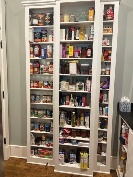

Food and supply storage is still the primary function of a pantry, with versatile storage a must. We build in adjustable full-height shelving in depths ranging from as narrow as 4 inches for single cans to 16 inches deep for bulky items like laundry detergent. We try to optimize the shelving layout to eliminate blind corners (where access to shelves on one wall is blocked by shelving on an adjacent wall) and maximize floor space.

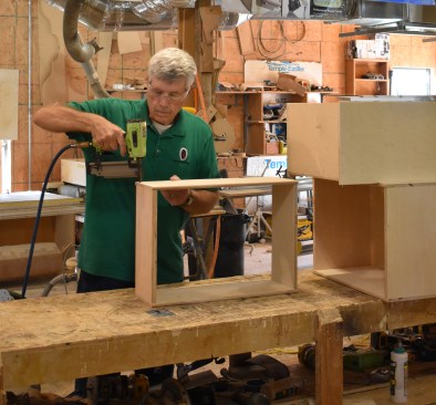

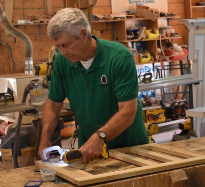

When a client wants pantry cabinetry with doors and drawers, the author assembles poplar face frames with pocket screws. The frames are then fastened to the cabinet boxes.

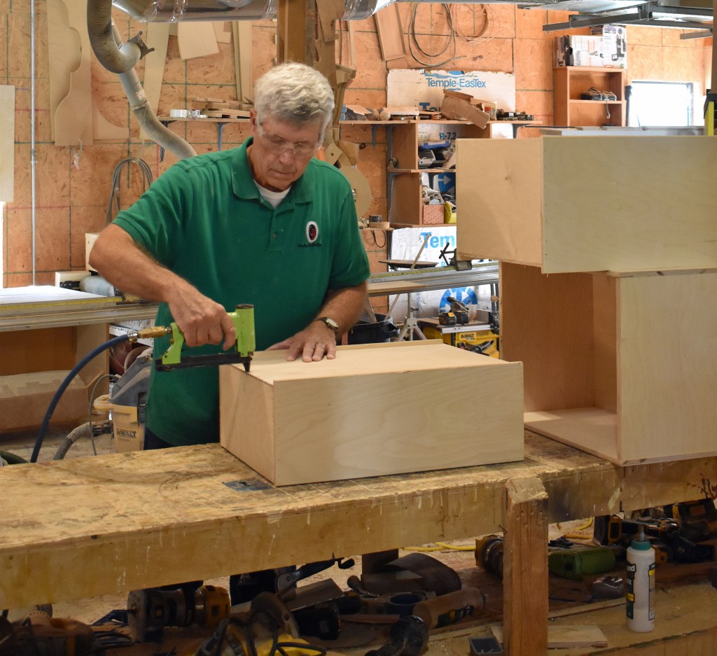

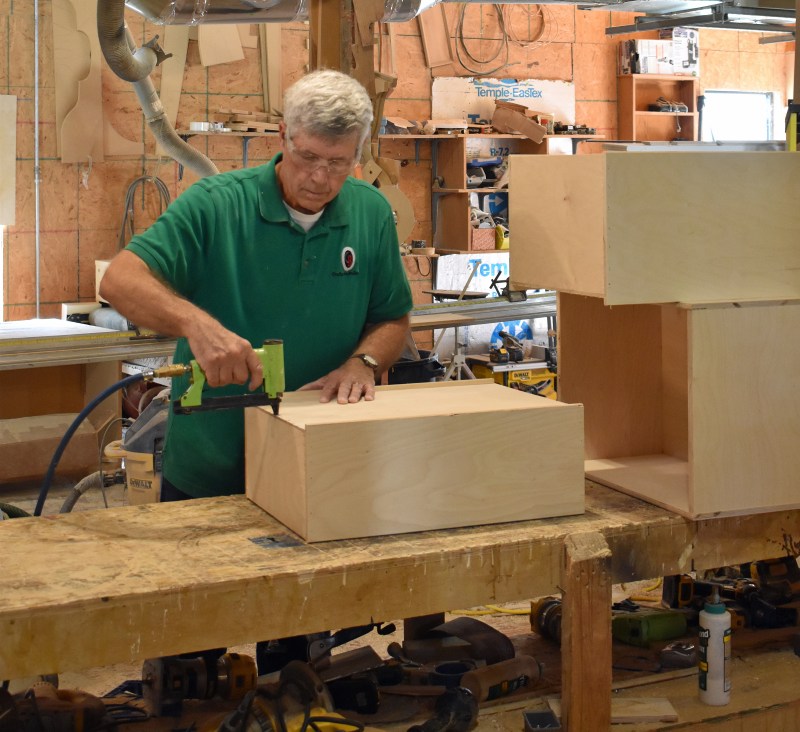

Utilitarian drawer boxes are assembled from plywood that has been ripped to width, cut to size, and glued and nailed together.

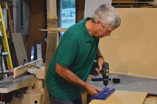

The author typically cuts shelving and shelf supports from MDF; to make the shelving adjustable, the author uses a Kreg shelf pin jig to drill holes in the supports for removable pins.
Our pantry shelves and cabinets are always painted, so we typically build the shelving using MDF. Since we use MDF extensively for interior trim elsewhere in the house, we are able to use up offcuts and rippings to make shelving and supports and reduce waste. Where there isn’t already a factory bullnose profile on our 3/4-inch-thick shelving stock, we apply it ourselves with a couple of passes of a router fitted with a 3/8-inch quarter-round bearing bit.

Oftentimes, clients want us to trim the shelf supports with face frames—which we also build out of poplar—to match the look of their kitchen cabinetry. For some clients, the pantry shelving is elevated to cabinetry with doors, drawers, and pull-out shelves, especially for base units. When we make these upgrades, though, we generally use more-utilitarian construction details than for our regular kitchen cabinetry. For example, most of our kitchens have undermount soft-close hardware and dovetail drawers; in a pantry, we nail the drawers together like plywood boxes and install them using side-mount full-extension slides.

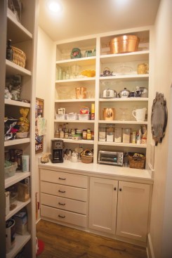

Pantry shelves can be sized to fit the space; shallow shelving provides good visibility and plenty of storage for cans and bottles.
Dishes, cookware, and other bulk items require deeper shelves.
To prevent sagging, the author limits shelf width to less than 30 inches.
A work surface – for food prep and for placing bags of groceries – is a key feature in a pantry.

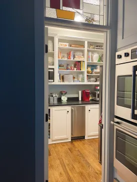

Appliances, Accessories, and Access

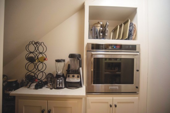

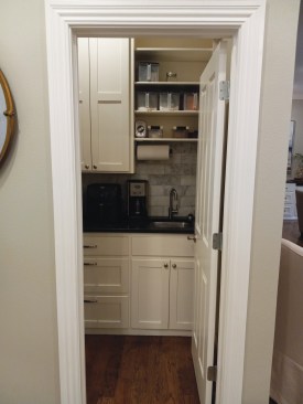

Many of our clients move small appliances like coffee makers or wine coolers into the pantry to get them out of sight. One client added a sink, simply to be able to fill their coffee pot and rinse it out afterward. With limited upper cabinet space in the main kitchen, sometimes clients decide to move their microwave into the pantry too. Another option is to simply add a second micro­wave in the pantry; once we even added a second oven there.

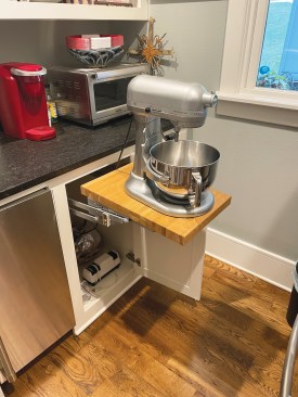

To minimize clutter, consider adding convenience hardware to pantry cabinetry, such as this mixer lift.

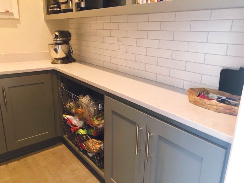

Convenience hardware such as pull-out trash bin slides and appliance lifts are popular base-cabinet upgrades for our clients. We typically use Rev-a-Shelf hardware, because the quality is good and it’s easy to point clients to the company’s website for design ideas.
Pull-out baskets that aren't hidden behind a cabinet door offer convenient storage for frequently-used dry goods.

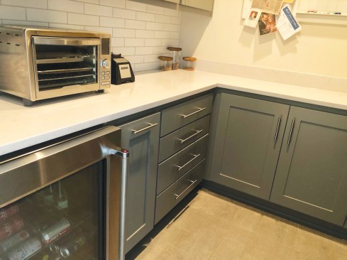

Be sure that the pantry is fitted with plenty of counter-height receptacles for small appliances such as toaster ovens and microwaves.
Serious chefs will appreciate having a second oven—and storage for frequently used baking supplies—close at hand in a pantry.

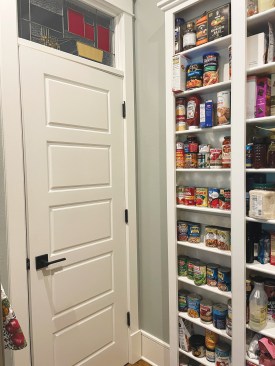

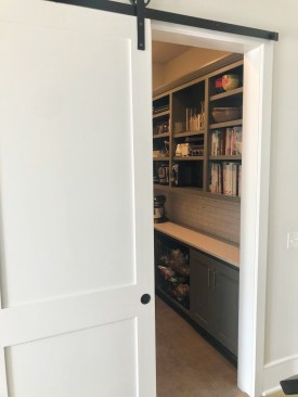

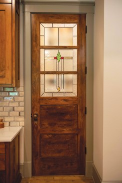

We also pay extra attention to the entry door into the pantry. Some clients opt for a pocket door so that no part of the pantry is blocked by an inswing door. Transoms (when there are tall ceilings) and custom glass in doors are also popular; we’ve custom-built several pantry doors fitted with decorative glass.
One advantage of shallow shelving for canned goods is that the shelves won’t interfere with the operation of an in-swinging entry door into the pantry.
This can be important when the design of the adjacent kitchen doesn't allow for an out-swinging door.
When space is tight, making an in-swinging door problematic, consider a pocket door or a sliding door fitted with barn-door-style hardware.
Fitting the door into the pantry with decorative glass offers a stylish touch and a degree of illumination, while blocking views of pantry clutter when the door is closed.
