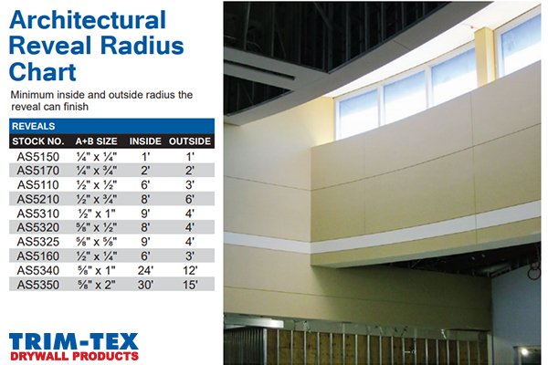

A second advantage that flexibility offers is the ability to easily bend vinyl reveal bead to fit around curves. Arched or curved designs no longer need to be finished with costly custom aluminum reveals that require long lead times. The most important step to curving Reveal Beads is getting an accurate measurement. To make sure you get the right reveal for the job, measure the radius of the curve and then refer to the chart found above or on the Trim-Tex website.
