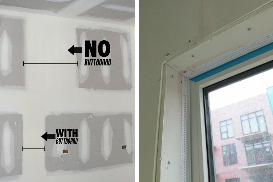

Proactive and effective building is imperative in today’s industry where material costs are on the rise. It is tempting to cut corners to finish jobs quickly and as cheaply as possible, but this does not pay off in the long run. An example is the trend towards floor to ceiling windows: As this has caught on, so has the practice of caulking and flat taping around windows. This bad practice results in a flexible caulk getting covered by a brittle finishing compound, will cause the finish to crack. To avoid callback, properly finish floor to ceiling windows by properly sealing around the windows with spray foam, creating water-resistant drywall edges, and reducing sound transmission. Trim-Tex offers eight different Tear Away Bead solutions for finishing around windows that address these top concerns and will last for years to come.

Even products that can appear to be an added cost, can in the end save you time and money. For instance, drywall finishers often consider Buttboard a luxury product or added cost. However, contractors find that Buttboard pays for itself by saving time (meaning labor hours) by eliminating the need for extensive feathering of the butt-joint. Another time-saving drywall finishing solution, is Fire Rated 093V Expansion Bead. The product is designed to alleviate the time it takes to properly finish fire rated walls that require expansion protection. Previously adding a fire-rated expansion joint to a wall required multiple products with multi-step installation. Trim-Tex developed Fire-Rated 093V Expansion to provide twice the expansion control of a standard zinc beads in addition to a factory applied intumescent tape that expands when exposed to heat. This all-in-one product saves big on installation costs. Instead of cutting corners and risking your reputation, look for money and labor saving products like these to help you work smarter.
