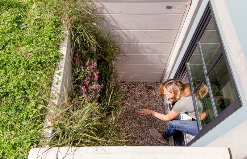

Egress vs. Emergency Escape and Rescue Openings
A common misconception is that these windows are purely for egress — an exit point during an emergency.
“It’s not just about getting out — it’s also about rescue,” he says. “A firefighter needs to be able to enter and remove someone who is unconscious or injured.”
Remember: It’s called an emergency escape AND rescue opening. That’s why the IRC has strict size requirements to ensure accessibility:
  • Minimum width: 20 inches
  • Minimum height: 24 inches
  • Minimum clear opening: 5.7 square feet
  • Maximum sill height: 44 inches from the floor
