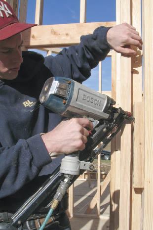

As a framing contractor, I rely on nail guns more than almost any other tool. When I buy a framing gun I look for a model that is comfortable to handle, able to toenail well, and powerful enough to drive nails flush every time. For this article, my crew tested 12 stick nailers: the Bosch SN350-34C, the Bostitch F28WW and F33PT, the DeWalt D51825, the Grip-Rite GRTFC83, the Hitachi NR83AA3, the Makita AN943, the Max SN883CH/34, the Paslode PF350S, the Porter-Cable FC350A, the Ridgid R350CHA, and the Senco SN901XP.
Most manufacturers produce two versions of every gun – one for 30- to 34-degree nails (usually clipped-head) and another for 20- to 22-degree nails (usually full round-head). Here in western New York, 30- to 34-degree paper-collated nails are the norm, so that’s the kind of gun we tested. (The one exception is the Bostitch F28WW, which takes 28-degree wire-collated nails.) The equivalent models for 20- to 22-degree plastic-collated fasteners are listed in the spec chart on page 68.
My crew and I used the tools for several months, trading guns around so we all had experience with each of them. Since we framed several large houses during that period, we were able to evaluate the performance of these tools under real-world conditions.

Over time, the carpenters on our crew gravitated toward the same three framing guns. In descending order of preference they were the Paslode, the DeWalt, and the Bosch.
Paslode’s gun feels powerful in use and came out on top in our nailing test. It’s lighter than average and has a comfortable contoured grip and trigger. The metal rafter hook pivots to several positions and is wide enough to fit over thick engineered framing members.
With its comfortable grip and trigger, the DeWalt was a crew favorite. The board hook pivots freely and will fit over thick framing material, and the push-button depth-of-drive mechanism is very easy to set. Although not particularly light, the tool is well-balanced and easy to handle.
The Bosch proved its power in the field and was the No. 2 model in our nailing test. It has a sharp aggressive nosepiece, a comfortable ribbed grip, and a quick-release magazine that makes it easy to clear jams. The slim piston housing makes for a very good view to the tip. This gun would have placed higher if it came with a board hook.

Bosch SN350-34C
The SN350-34C is one of our favorites, a powerful gun with a slimmer-than-normal piston housing that makes for a good line of sight to the tip. It has a couple of unique and useful features: a metal strike plate on top for tapping studs into position and a quick-release magazine that can be removed to clear jammed fasteners. The ribbed rubber grip is comfortable to hold, and the aggressive tip grabs well when toenailing. Our one complaint is that this tool does not include a rafter hook; the manufacturer sells an optional one, but it’s hard to find and will set you back $25.
