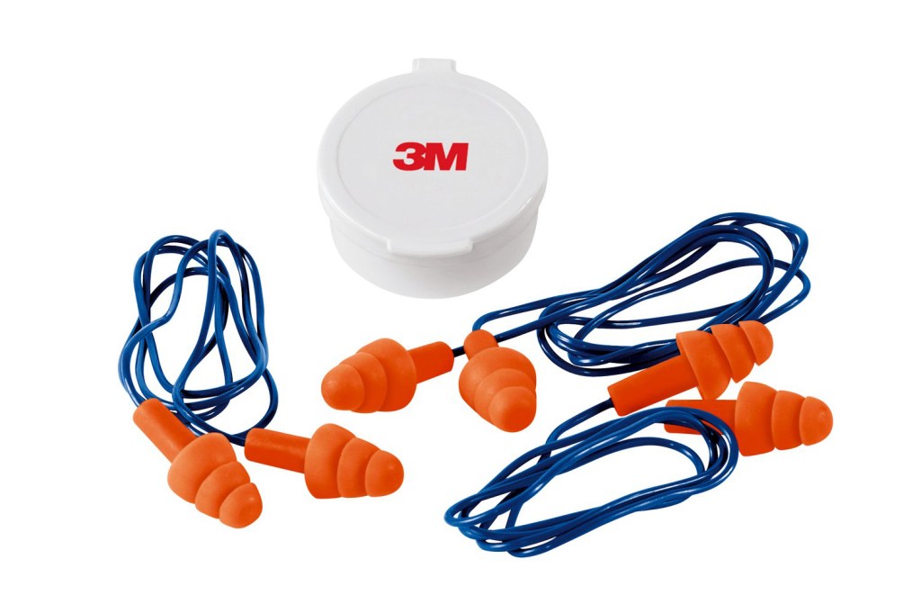

Earplugs
Photo courtesy of 3M

For example, earplugs need to go deeper in the ear canal than most realize. When the earplug is fit correctly, someone looking directly at you should not be able to see the earplug extending out from your ear.
How do you verify proper fit of an earplug? After you’ve inserted the earplugs, cup your hands over your ears. If you hear a drop in the ambient noise around you, it means the earplugs weren’t fit properly and you need to refit them. If the ambient noise level stays the same, it‘s an indication that you have achieved a proper fit.
