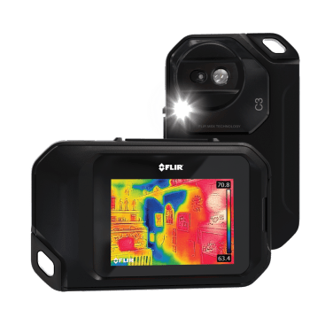

The new C3 looks like and functions similarly to the C2, which Doug Horgan reviewed for JLC (see “New Infrared Options for Remodelers,” Jun/15). Like its predecessor, the C3 is a pocket-sized, touch-screen unit that combines a visual camera with an IR imager. Both have a thermal resolution of 80×60 and allow you to save infrared and visual images at the same time. These cameras also have a function that Flir calls “MSX” overlay—a view that combines the IR image with faint lines outlining objects and patterns from the visual image. According to Horgan, the MSX image provides a clear representation of the captured area, along with the thermal information you need. The C3 includes other functions as well, like Wi-Fi connectivity—allowing you to mirror whatever you’re capturing onto your phone or tablet through the Flir Tools App—and the ability to locate the lowest or highest temperature within a chosen area on the screen. The C3 sells for $700; the C2 is now available for $500.

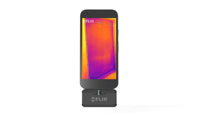

If neither of those options is in your budget, you might consider the third-generation FlirOne—also available in a new Pro model. Like the C2 and C3, both FlirOne models provide visual and IR images along with the MSX overlay. Both options also have a new adjustable-height connector, which is meant to adapt the fit for most phone and tablet cases on the market. The visual image output resolution for both cameras is 1440×1080. The standard FlirOne has a thermal resolution of 80×60 and will cost $200. The FlirOne Pro has a thermal resolution of 160×120 and will cost $400. flir.com
