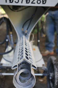

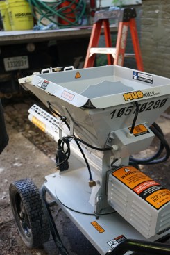

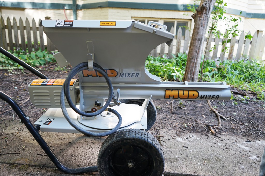

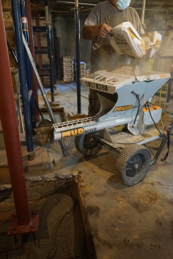

The MudMixer is an onsite concrete mixer made by a small, Texas-based company of the same name. We've been using one for almost a year, first renting one and about six months ago we bought one, and so far it has been an absolute game changer. The MudMixer is similar to a volumetric concrete mixer except that the water is added, and the concrete is mixed, in the chute, making it different than any other electric mixer on the market. Weighing in at only 145 lbs., it’s extremely mobile, and very easy for two people to load on the truck, and unload at the end of the day. Virtually the whole machine is made from 14-gauge steel that is powder-coated grey; it seems extremely robust, and heavy-duty.

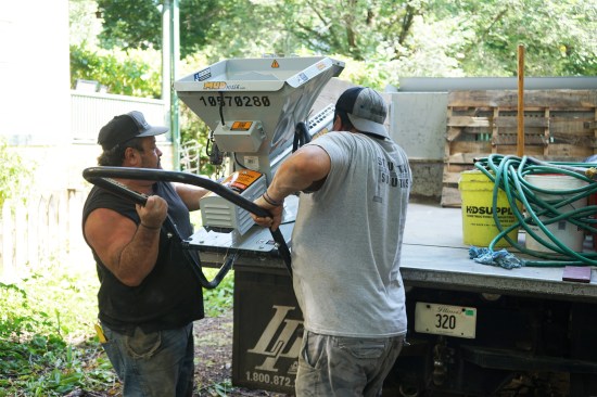

At 145 lbs., the MudMixer proves extremely mobile. Two workers can easily load it on the truck, or more to the point, unload it at the end of the day.

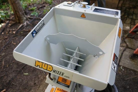

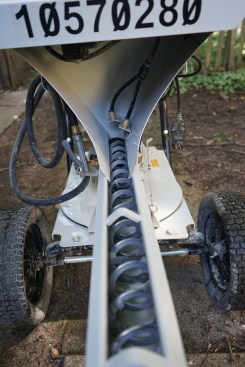

MudMixer claims to be able to mix 40 bags per hour, and we have verified that. This makes mixing a whole pallet of 80 lbs bags of concrete an hour or so project. The MudMixer has a big splitter that runs down the center of the hopper that practically automates opening bagged material. When it comes to adding water, we’re running a garden hose to the mixer. Here there is a valve where we can control the precise amount of water saturating our mix, giving us consistent and uniform results. Cleaning is easy too, it has an onboard hose and only takes a few minutes. Typically, we are left with less than a full bucket of grey water.
Dust generated from bagged goods is still very much an issue, but not any worse then what we are already accustomed to. MudMixer is a professional grade tool, made to withstand the rigors of the job site, and it comes with a price tag to match: $2,995.00. If you mix 20, 30, 40 plus pallets of concrete a year, its going to be a no brainer; this tool will pay for itself quickly. Stay tuned for our 100,000-bags, long-term review, when we are going to see if this mixer is as durable and maintenance free as the manufacture claims.
