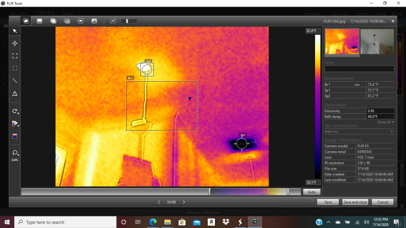

A thermal camera is often one of the first tools the author pulls out first to scan a site for possible hidden moisture.  Dark areas on the image indicate cool areas—places that may be wet and need further investigation.

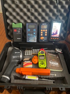

Learning about measuring moisture content started me down a path that led to my acquiring a Pelican case full of diagnostic tools, most of which are designed to measure moisture in one form or another within building materials and in the environment inside or outside buildings. These days, I live and work in New Orleans. I was drawn here shortly after Hurricane Katrina devastated large swaths of the city, and I saw how I could be useful in helping to rebuild the 9th Ward, which was particularly devastated by floods from Katrina and subsequent storms. For this work, and for ongoing work here in this hot, humid climate, reading moisture is a big part of defining effective building solutions.
The author’s inspection case contains a range of tools for measuring moisture.
In this article, I will “unpack” my case. Not only do the tools within allow me to derive quantifiable moisture measurements, but just as important, many of them streamline how I document the problems I encounter, which helps me communicate the solutions I come up with to clients and subcontractors. Data is every­thing. I have learned that to be convincing and to educate clients, it is essential to have tools that will quantify environmental conditions, including, but not limited to, wood and drywall moisture content (MC), relative humidity (RH), temperature, and observable (that is, graphic) conditions.

A thermal camera reads infrared radiation, and shows surface temperatures. But it can be used to highlight moisture problems as well as thermal losses. When wet materials dry, they become cooler—like what happens to the temperature of skin when you perspire: The skin surface cools. The same thing happens with building materials, provided the air temperature is warm enough to allow evaporation. The cooler surfaces show up on a camera as darker colors. Of course, something showing up on the image at a lower temperature can simply be cooler, not necessarily wet. But if I scan an area, and it shows up with patches that are cooler, that gives me a clue to chase down: It may indicate a wetter, not just a cooler, area, and I know a little analysis is called for.
I always begin a building investigation looking for moisture accumulation using a thermal camera, and work it in tandem with a moisture meter to check for elevated moisture content. The thermal camera simply gives me the best place to “look” further with my moisture meter.
The camera image is especially useful for identifying potential condensing surfaces, where liquid water exists. These are the most likely places for microbial growth to occur. In image (2) on page 27, the AC register, shown clearly in dark purple, had been cooled enough by the supply airflow to drop the grille surface below the dew point. This resulted in dripping water and led to biological organic growth on the surface. I will discuss the environmental conditions detected using Kestrel meters later in the article.
Flir thermal camera. Thermal cameras are becoming more available and more affordable. I use a Flir E5, which is relatively inexpensive for a thermal camera. I paid around $1,500 for mine several years ago. There are less expensive models and even devices that will connect to a smartphone to provide some thermal imaging. I like stand-alone ones that can connect to a computer and provide more-precise images that can be output as records. The camera I use can take two images: a thermal image and a black-and-white image that highlights the dark areas most likely to be moisture. With the Flir tools, temperatures can be pinpointed on the image where there might be an anomaly of interest.

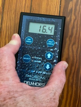

The Delmhorst ProScan can read wood moisture content to a depth of 3/4 inch without marring finished surfaces.

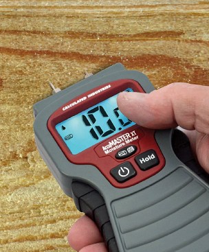

The author recommends an affordable pin meter like this as a starting point for someone beginning to develop a habit of checking moisture content.
Calculated Industries
AccuMaster XT. There are lower-cost pin meters available that can provide accurate readings. One stand-out is the AccuMaster XT from Calculated Industries, which costs about $45. Its readings compare favorably to my Mini-Ligno’s, and while it might not be as adjustable, it can still be adjusted to low, medium, and high percentage ranges for different types of materials and moisture levels. It would make a great starter meter for someone beginning to develop a habit of checking moisture content. If I succeed at anything with this article, I hope it’s to persuade every contractor to use a moisture meter. Cost need not be an issue.
Delmhorst ProScan. This pinless moisture meter uses scanning technology to detect moisture below the surface of materials. The two main attractions of pinless meters are:
  • Moisture detection to 3/4 inch.
  • No marring of surfaces.
The ProScan can be set to several different species of wood and to a reference scale for nonwood materials. It is the first pinless meter I used, and I have always been satisfied with the reading. But recently, I have been attracted to devices that can also help me document jobs.

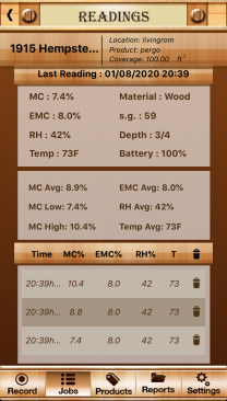

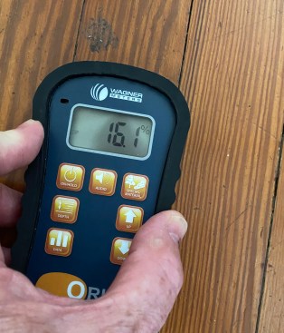

The author likes the Wagner Orion 950 pinless meter for its ability to save and record several readings, including moisture content, equilibrium moisture content (EMC), relative humidity, temperature, time, date, and location.  Calculated results can be deliver on the author’s phone (left) and reports can be sent via email.
Wagner Orion 950 pinless meter. I like this pinless meter primarily for its ability to save and record several readings, including moisture content, equilibrium moisture content (EMC), relative humidity, temperature, time, date, and location. EMC is a particularly good reading for use in acclimating building materials—it’s a calculation of the moisture content relative to the temperature and humidity recorded in the surrounding environment. It’s the target moisture content, so to speak, for the actual environmental conditions of the space you’re in.

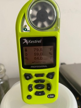

Data Recorders

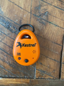

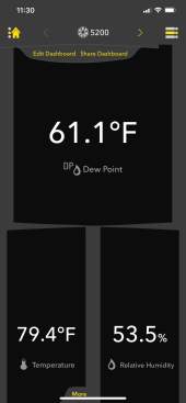

Increasingly, I have become interested in not only measuring moisture in materials, but also tracking and recording environmental conditions on the jobsite. This helps me better understand condensation potentials and predict where problems might occur. There is quite a range of environmental data to measure, but for my purposes, what I find most useful is humidity ratio, or grains. When the humidity ratio is above 100, comfort and moisture problems tend to result.
Kestrel environmental data recorders. I use two types of recorders made by Kestrel: The larger 5200 (see photos above) is useful for more detailed reports, and the smaller D2 (I have two) I like for quick readings in attics, in crawlspaces, and on poles at various elevations in a room. These readings are essential to analyzing why certain things are happening.
For example, when there is water dripping from HVAC registers on high ceilings, I can attach one of the small D2s to a ZipWall pole and take temperature, relative humidity, and dew-point readings at the ceiling register to compare with readings at countertop height and floor level. I have discovered that in older homes when new high-SEER HVAC systems replace older, less energy-efficient systems, the newer system puts out colder air. And humid air, much like hot air, is buoyant. This means that the RH and dew point are likely to be higher near tall ceilings. Combine that with cooler air that may be cooling the register grille to below dew point, and you get dripping water. Using the Kestrel recorders, I am better able to document and explain what is happening. Both models allow me to capture a range of conditions and output those in an email to the client.

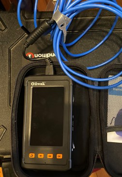

For looking inside building cavities, Robinson uses an Oiiwak borescope with a digital display.
Borescope. For looking inside building assemblies, I use a 5.5mm Oiiwak borescope. The Oiiwak has a nice interface that allows me to capture and output images that I can share with clients.
