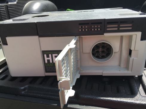

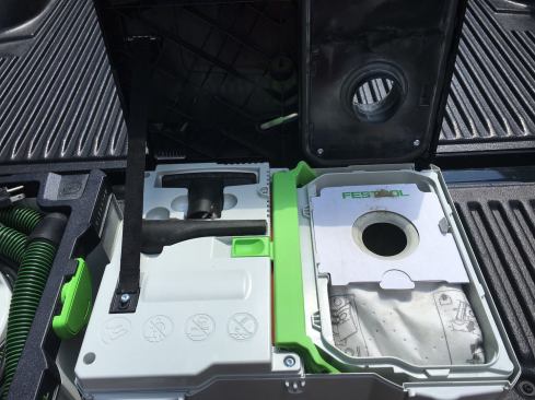

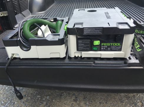

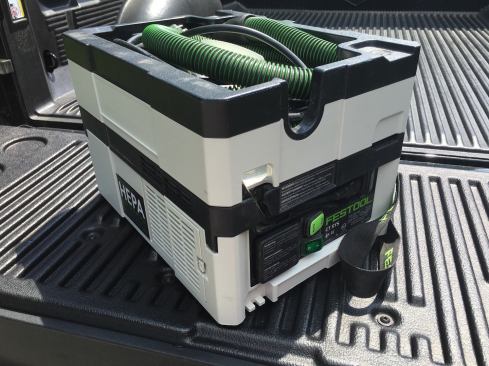

The Festool CT SYS is a portable dust extractor with full HEPA certification aimed at remodelers and painters. Unlike your typical R2D2- or BB-8–like roll-around dust extractor, the CT SYS is designed for ultimate portability. It features an integrated shoulder strap, built-in carrying handle, as well as the cord and hose “garage” that is on all of Festool’s dust extractors. I tested it out on various jobs including interior trim prep, built-in construction, window restoration, and some drywall work, as well. I found the dust extractor to be way more powerful than you’d expect given its compact design.

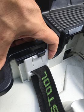

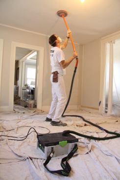

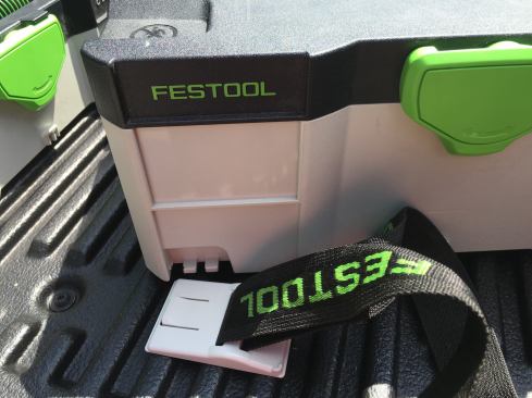

Next I hooked the dust extractor up to my Bosch random orbit sander to strip some old windows and it kept up nicely. I can’t quantify the amount of dust-in vs. dust left behind, but I can say that there wasn’t any noticeable dust in the air as I sanded. This gave me enough confidence to use the vac and sander to prep interior trim that needed repainting. I really appreciated being able to carry the vac over my shoulder as I worked around the room here. That said, I was disappointed that the shoulder strap clips gave way when mounted to the side of the unit and the extractor slammed to the floor when I hopped off of a stool. There are mounts within the hose / cord “garage”, but I preferred working in this setup without that attached to the unit because of its added weight. The strap and unit interface on the side of the extractor could use some attention – some way to make a stronger connection. The unit might sustain the blow of a 3-foot drop, but not necessarily from higher up a ladder. Then there’s the surface it lands on to consider. I was fortunate that neither the extractor nor the floor had any issues from the fall.

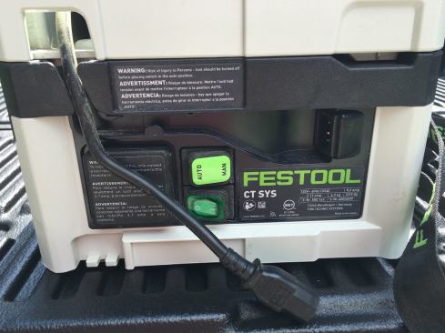

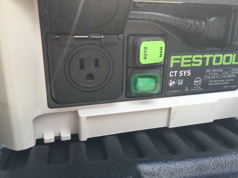

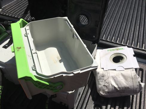

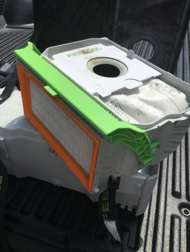

I like the compact design and power that the unit provides. It does a good job catching fine dust when sanding and sawing with a jig saw or track saw. When connected to Festool’s HKC-55, the unit did an incredible job extracting dust from Versatex – a product that creates ample amounts of super fine dust. I was disappointed by the shoulder-strap interface, and found the cord hookup a little awkward to maneuver; I wish the CT SYS featured Plug-it technology. The hose / cord “garage” is a nice built-in feature, and the Systainer integration capability is excellent if you are already invested in the Systainer system. My favorite feature of the dust extractor is the hose because of its weight, length, and flexibility. And, relatively speaking, it’s pretty quiet for a vacuum. All of that said, the $375 price tag is hard to swallow even if the vac is powerful and extremely portable. If you have a fair amount of Festool products, the Systainer functionality alon might be worth the price to you, and it’s engineered to work with other Festool tools, which it illustrated nicely on the HK-55 saw that I was using. However, I might be inclined to buy a similar type unit for a third the price and upgrade it with the Festool hose ($110) if budget were a concern.

Max. Suction Capacity 106 CFM
Maximum Vacuum 80” static water lift
Noise (Sound Level) 67 dBA
Power Consumption 1000 watts, 8.3 amps 120 V AC
Power Cord Length 16’
Product Weight 15.2 lbs
Country of Origin Germany
Cost $375 (includes Anti-static hose, (1) HEPA filter, (1) disposable filter bag)
