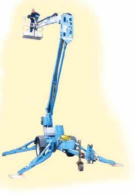

For about $200 per day, the author uses a Z-Boom articulated lift to reach high areas when a ladder isn’t practical. The model shown here — TZ-34/20 — has a maximum height of 40 feet and a basket capacity of 500 pounds. Genie TZ-34/20
Working height: 40 feet
Horizontal reach: 18 feet 4 inches
Up-and-over reach: 16 feet 1 inch
Basket capacity: 500 pounds
Genie Industries
800/536-1810
www.genieindustries.com

At the site, I position the lift as close as possible to where we need it. Even though the boom has wheels, moving it is nearly impossible without at least two people (three is better). Pushing the machine up anything but the slightest grade is even harder. So when a site is steep, we bring plenty of manpower for positioning.
The Z-Booms have outriggers that take weight off the trailer’s suspension and level the base. Deployed, they make the unit’s footprint significantly larger — something to keep in mind when positioning the machine. We put 3/4-inch plywood scraps under the outrigger feet to prevent damage and keep the feet from sinking into the ground.
The user controls are pretty simple; the trick is getting the workbasket in just the right spot. Maneuvering the arm and basket can be counter-intuitive — sometimes, because of the Z-shaped boom, you have to go up and over a roof to get under a soffit. It’s a slow process. Moving the basket into position can take five minutes or more. And once it’s up there, it’s an island in the sky — getting materials can require another five-minute trip. This back-and-forth eats up a significant amount of time.
Repositioning the base is a time-killer, too, because the arm has to be fully bedded and the outriggers retracted. We always plan the initial placement carefully, so we can access everything with as few base-unit moves as possible. Knowing the machine’s exact reach and taking careful measurements helps when figuring out placement.
The units we rent have two 110-volt receptacles in the workbasket for tools and lights, but we use cordless tools whenever we can. With two people in the basket, cords tend to make the space feel even smaller.
