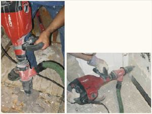

Dust Remover
The TE DRS-B consists of a rubber nozzle attached to a vacuum port. The port slips over the front end of a breaker or combination hammer and fastens in place with a cam-lock lever. When the vacuum is on, dust and chips from around the bit are sucked in through the nozzle. We found that the attachment captures most of the dust coming off the chisel, as well as chips up to about the size of a quarter. But it worked better on floors than on walls; when we broke up vertical surfaces, large chunks of tile and mortar fell and created clouds of dust when they hit the floor. Still, using this attachment was better than working without any dust collection at all.
The Dust Remover comes with two vacuum nozzles — one for chisels up to 16 inches long and one for chisels up to 20 inches long. It’s designed to work with bushing bits, pointed chisels, and flat chisels up to 3 inches wide. A different attachment collects dust while drilling. It costs $160, and the TE 706-AVR — the breaker we used it with — $1,150. The combined cost is significantly higher than the price of comparable breakers from other manufacturers. But I look at it this way: If I spread the amount over the 20 demo jobs we do per year, the expense would come to $65 per project. After that, the tools are paid for. And some of that money would come back to us in reduced cleanup labor.
The Dust Remover fits over the end of a Hilti breaker or combination hammer and — when connected to a vacuum — sucks up dust and chips generated by the bit. The author found that the tool was most effective when he was breaking horizontal surfaces (left); less dust was captured on walls, where the hammering knocked loose material onto the floor (right). Vacuum
