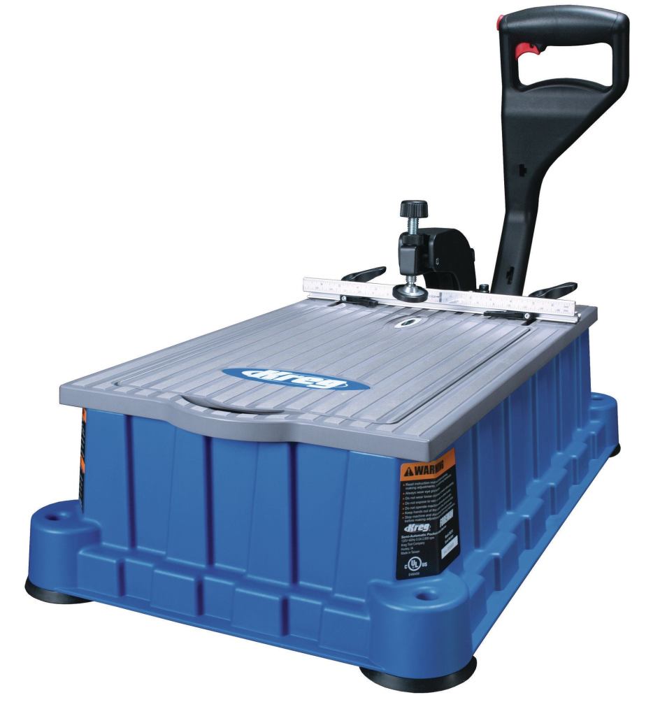

But Kreg has now replaced the Foreman DB110 with the Foreman DB210, which costs $400 and weighs just 20 pounds. After using the DB210 twice on jobsites and once in the workshop, I think it’s a game changer.
PERFORMANCE
When the new Foreman arrived, I installed the included vacuum port, shroud, and hose inside the base so I could hook it to a vacuum. The machine accommodates materials from 1/2 inch to 1 1/2 inches thick. You need to follow a simple, three-step procedure to adjust for the thickness of the stock and the length of your screws. One caution: If you don’t adjust it properly, you can drill right through the fence when you pull the handle (don’t ask how I know that).
So far, I’ve used the new Foreman to splice 1×8 baseboards, join window and door casings, and build cabinets. It drilled the pockets cleanly and accurately, and the dust collection worked great when I hooked it to my Fein vacuum. The base has rubberized feet and grips surfaces well, but you can also clamp or bolt it down.
I do have minor complaints. The handle, which contains the trigger and lockout button, is awkward to use left-handed. Although I’m a righty, work flow sometimes requires holding material with my right hand, and it would be helpful to be able to easily operate the handle with my left hand.
Also, although the fence has adjustable and retractable stops for repetitive drilling, they’re small pieces of plastic that slip into a T-slot and are secured with socket-head screws. Small plastic parts are seldom durable enough to stand up to rigors of shop and jobsite work, and the screw heads are so close to the tabletop that turning a hex key to loosen or tighten them is a bother.
The DB210 has a 5-amp motor versus the 8-amp one on its pricier predecessor, so I would use an especially sharp bit with hardwoods.
Criticisms aside, this new Foreman performed well. It’s not designed to replace the industrial machines used in production shops, but I expect it to become a popular tool on jobsites and in small shops.
