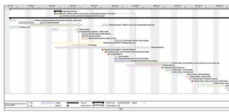

Most homeowners don’t realize that plumbing roughs are dictated by final fixture selections, or that tardy decisions can throw a project off schedule. While clients do need to know the ramifications of delayed choices, our company doesn’t like to impose penalties for missed selection deadlines. Instead, we use several tools to educate clients about how timely decisions save time and therefore money.
We use a Gantt chart, for instance, to show milestones in relation to install dates. And we ask the client to attend weekly site meetings with the project manager, the designer, and (on an ad hoc basis) support staff like myself to address any budget or schedule changes. When a client can’t finalize a detail, these tools help us collectively figure out ways to switch things around to stay on schedule.
