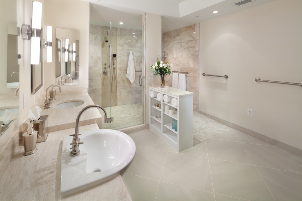

This bathroom by Glickman Design Build, which won a 2015 Chrysalis National Residential Universal Design Award, features accessible features such as grab bars, lever faucets, and a zero-threshold entry to the double shower.

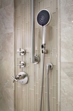

The threshold isn’t the only thing to think about in the shower: Glickman notes that it’s important to include a handheld shower and consider the position and accessibility of the controls.

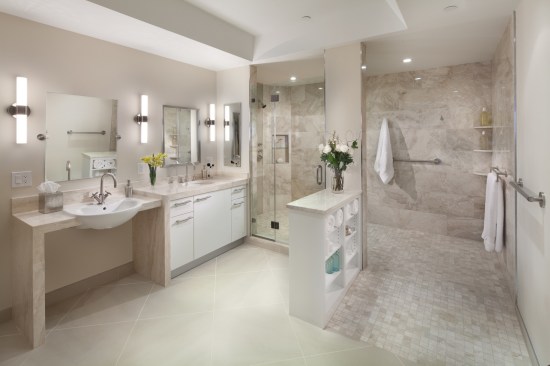

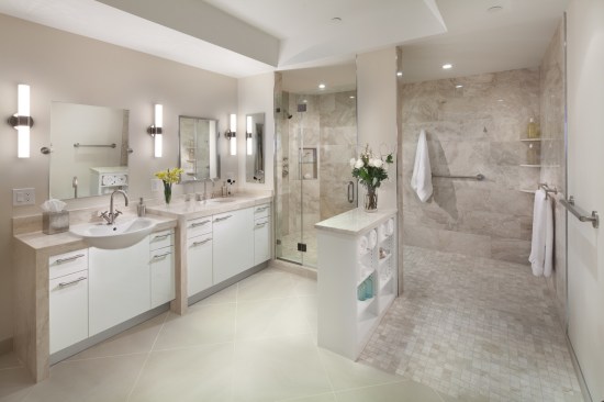

This bathroom also includes adaptable features, such as undersink cabinetry that can be easily removed to provide clearance for a person in a wheelchair, as shown in the image below.
