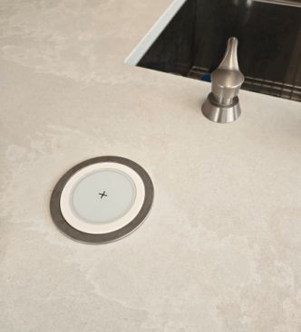

Hezi's pop-up countertop outlet
Hezi's pop-up countertop outlet, available at Amazon for about $200, also provides wireless charging in both the closed (left) and open (right) positions.

Cost is a factor with pop-ups. The ones we used in that island cost around $160 each, giving the client 12 outlets, each with USB (both A and C types). So, we saved money on all the outlet wiring we would have had to do under the old code.
Pop-up outlets range from around $150 to $600 with lots of choice in colors and features. These devices have been around for 20 years or so, and the code-rated ones available now are waterproof and have gaskets to keep out water and debris. The ones we’ve used seem well-made, so I am not particularly concerned about their durability.

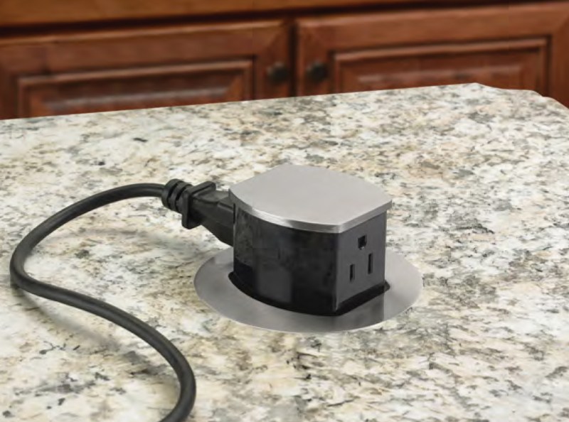

Hubbell TradeSelect polished chrome pop-up outlet
Hubbell TradeSelect polished chrome pop-up outlet.

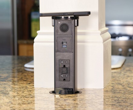

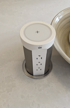

Lew Electric Pur20GACBTQD pop-up outlet with Bluetooth.
We just put in a Hezi pop-up that the client purchased from Amazon for $200 that installed well. We have been having discussions in our office about which ones to make standard for our operation. Our electricians have suggested an offering from Hubbell, which makes a discreet single-plug pop-up with USB A/C on the other side (hubbell.com). The downside, of course, is having only one outlet, but this device offers wireless charging on top, which is a useful consolation. Lew Electric Fittings (lewelectric.com) sells a giant tower of outlets for those who want just one pop-up hub, starting at around $250. And Point Pod makes a motorized pop-up that you can finish with a piece of the countertop material; once installed, it is almost invisible with just a narrow edge of the sleeve showing. At about $600, these are among the most expensive of the pop-ups we’ve seen (pointpod.com).
