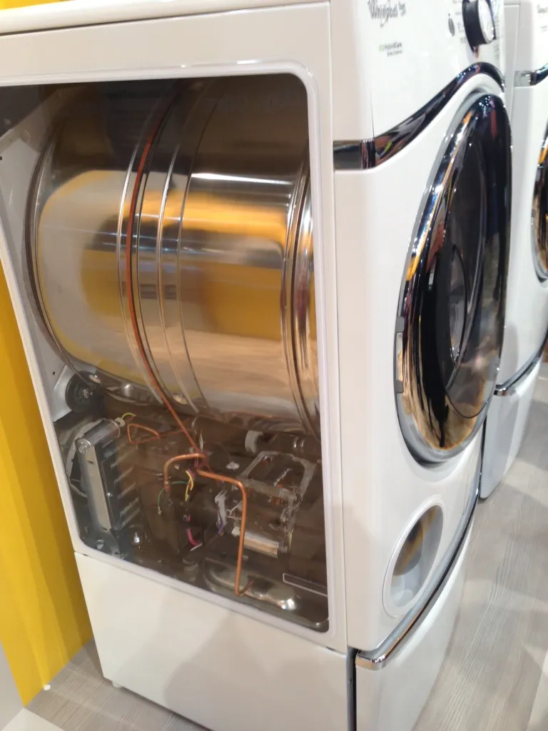

Similar to heat pump water heaters, which extract heat from the surrounding air to bolster water heating capabilities, heat pump dryers recirculate their own excess heat so the appliance can deliver the same amount of drying power with considerably less energy input. Whirlpool's Duet dryer with Hybrid Care (above) is ventless and uses up to 70% less energy than a standard dryer, while maintaining a standard 60-minute drying cycle. The technology won a CES Innovation Award this year. LG's heat EcoHybrid pump dryer (left) boasts up to 53% energy savings and is also an award winner, taking home an Energy Star Emerging Technology Award over the summer. Of course, with high technology comes higher price tags. As heat pump dryers start to roll out, look for price points of at least $1,500.
