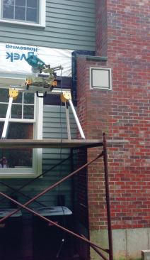

The LS0714 weighs only about 29 pounds, or about half as much as a comparable 10-inch or 12-inch slider. It’s never an issue to drag it out for a couple of cuts, and when trimming interiors it’s normally more productive to move this compact saw from room to room than to set up a fixed high-capacity miter-saw station and walk back and forth for every cut. Because I can lift the saw with one hand, I can easily bring it up a ladder and set it on staging for cutting siding or trim.

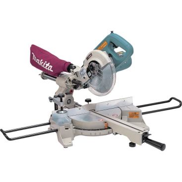

The LS0714 can miter 47 degrees to the left and a generous 57 degrees to the right. And although a detent override allows for a bevel up to 5 degrees to the right (a feature I often use to back-cut wide pieces), it’s basically a single-?bevel saw and can only bevel 45 degrees to the left. That doesn’t help when trimming out-of-square old houses, and it sometimes means having to flip the stock end-for-end when cutting bevels or compound angles. (With dual-bevel saws, instead of flipping the stock, you can tilt the cutting head to either side—helpful when cutting long pieces in tight quarters.) But this beveling limitation has never been an issue for me; I plan my cuts, so I seldom have to flip the stock.
Helpful Accessories
I like the saw’s small 7 1/2-inch blade diameter because it limits deflection and wobble. Instead of the stock 40-tooth Makita blade, though, I use a 60-tooth Forrest Chopmaster blade (model CM07H606100), which costs about $107. It’s about 50% thicker than Makita’s blade and safely makes very clean cuts in the tiniest of moldings. My larger miter saws tend to grab small pieces even when using a wood backer, but my LS0714 never does. It can also use common 7 ¼-inch blades in a pinch.

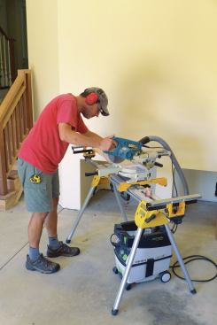

I normally mount the saw on DeWalt’s compact model DWX724 universal miter-saw stand equipped with extra-wide DW7029 work supports. The stand has a quick-release saw mount and folds for transport and storage. Together, saw and stand weigh under 60 pounds.
For dust collection, I hook the saw to a Festool CT Midi vacuum. Festool’s 1 7/16-inch hose end would normally fit loosely over the plastic dust port, but a few wraps of duct tape around the port expand the outside diameter to create a snug fit. I’ve never measured the amount of dust collected, but would conservatively estimate it to be about 80% to 85%.
