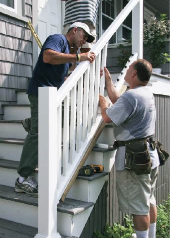

Installation of composites. Composite rails are easy to install. The carpenter slides the post covers over the 4×4 support posts, cuts the rails to length, then assembles the balustrade. In most cases, the balusters attach with screws driven through predrilled holes in the subrails. Once assembled, the balustrade is positioned between the posts, fastened in place, and covered with a top rail. While screwing in balusters is not the fastest method of assembly, it’s certainly the most bullet-proof, providing little opportunity for joints to open or balusters to rattle. Some manufacturers have devised methods to speed the installation of balusters by omitting the screws.
Rails are typically joined to posts with stainless-steel fasteners and L-shaped metal brackets that butt to the post and the bottom of the rail. While color-matched powder-coated brackets are fairly inconspicuous, a cleaner look is achieved with a two-piece rail that completely conceals the hardware, as with CertainTeed’s Panorama, TimberTech’s Radiance, and Trex’s Artisan series.

Installing vinyl rails. Vinyl systems are very easy to install because the balusters drop into holes in the rails. (The drawback is that because they’re not screwed into place, the balusters could rattle in the wind or squeak when someone leans on the rail.) The railing cuts aren’t critical because the connection is hidden by the plastic bracket.
