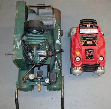

I was introduced to the Max PowerLite high-pressure pneumatic fastening system in 2007 while testing framing nailers for Tools of the Trade magazine. A Max 400-psi tool was included in the mix, and the company's AKHL1050E 400-psi compressor arrived along with it. Max had introduced the world's first 400-psi system in Japan back in 1994 - and brought it to the U.S. in 2003 - but I had never seen anything like it. Built for efficiency and ease of operation, the system was compact, lightweight, and extremely powerful.
The oilless compressor drew 15 amps, weighed just 51.7 pounds, and had a 2.6-gallon twin-pontoon tank that held as much air as a standard 8.3-gallon tank at 100 psi. It also had two standard and two high-pressure outlets with a separate regulator for each pair so it could operate both types of tools simultaneously.
Max is now replacing that compressor with the even lighter and more efficient AKHL1230E, and that's the version my crew and I recently test-drove. Here's what we learned.

The new 1230E weighs 46.3 pounds - less than a box of 16d sinkers - and is easy to carry with one hand. Like its predecessor, it has two standard and two high-pressure outlets and a 2.6-gallon twin-pontoon air tank. But the new model has three power modes instead of one.

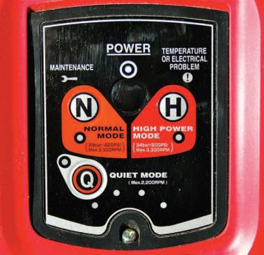

In Normal mode, the 1230E cuts in when the pressure drops to 360 psi and shuts off at 420 psi, providing enough air for most applications. But if you need a boost - such as when you're nailing 23„32-inch subfloor to I-joists - you can switch to High Power. In that mode, the compressor cuts in at 435 psi and keeps pumping until it reaches 500 psi. At 500 psi, the tank stores as much air as a standard 10-gallon compressor at 100 psi.
The unit hums along at only 73 decibels when running full blast. But if you're, say, doing punch work in an occupied home, you can switch to Quiet mode. That drops the speed of the motor from 3,300 to 2,200 rpm and emits no more than 68 decibels, making the compressor about as loud as a common household vacuum cleaner.

The control panel is located on top of the unit between the two regulators and their flush-mounted gauges; you can monitor the compressor at a glance and easily change the power settings with the push of a single button. One LED light tells you the unit is turned on, another (accompanied by beeps) warns of overheating or low voltage, and a third indicates when maintenance is due.

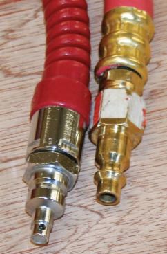

Normally if you disengage a standard hose from a pressurized compressor and let go, it will flail until the air pressure inside the hose is exhausted. Getting smacked in the shin by a metal coupling propelled at 120 psi hurts - so think how much more it would hurt if the hose were pumped up to 320 psi. Max apparently thought about this problem and designed a unique coupling to deal with it. Whereas a standard male hose fitting is open at the end and exhausts all the pressure in line with the hose, Max's high-pressure male fitting is capped at the end and has two small exhaust ports, one on either side, to help cancel out the force. If you release one of these pressurized hoses and let go, it typically falls to the ground and lays still as the air pressure dissipates.

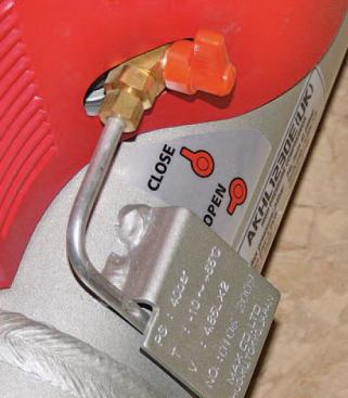

Easy drainage lever. Draining the air and water from compressor tanks each day helps prevent rusting. With my standard twin-tank compressors, I have to reach underneath each tank to find the drain valves. Not only that, but the valves themselves are often inoperable, because they're located in a place where they're vulnerable to damage. The 1230E has an easily accessible and better-protected ball valve. You simply turn the lever and both tanks drain.
