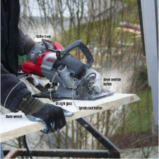

Irregular-pitch roofs require steeper bevels on cheek cuts than can be made with many older saws. This saw can tilt to 51.5 degrees, which is great for us because we frame a lot of these kinds of roofs. The default stops at a 45-degree bevel, but if you hit the override button you can tilt the saw to a steeper angle.
The Milwaukee saw has several added features of varying degrees of usefulness. The 6477-20 has oversize levers and a comfortable rubber grip. I don’t mind that the levers are plastic, as this has forced me to break my habit of overtightening the mechanisms. The tool comes with a sturdy steel rafter hook that can be folded out of the way against the housing. I like rafter hooks — every saw should have one, in my opinion.
The manufacturer makes much of the sight glass that allows users to easily check the oil level. This made me realize that I never check the level of oil in my other saws. It’s hard to get excited about this feature because I’ve killed a number of wormdrives without ever having one seize up for lack of oil.
