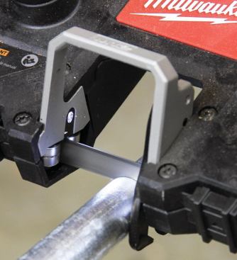

The throat of the saw will accept material up to 1 5/8 inches wide and deep — though the tool works best on smaller material. I tried it on 1 5/8-inch Unistrut; it worked, but if I had to cut a lot of this material I’d prefer to have a bigger saw.

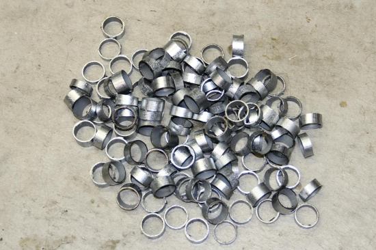

One question always comes up with new cordless tools: How much work can it do before you need to change batteries? According Milwaukee, the M12 band saw can make up to 150 cuts per charge in 3/4-inch electrical conduit with the supplied six-cell XC battery. Runtime is less with standard three-cell batteries.
I tested runtime by putting a new blade and a fresh XC battery in the machine and making short cuts in 3/4-inch conduit. To avoid overheating, I rested the tool for five or 10 minutes after every 24 cuts. The battery lasted for 128 cuts. Although the blade was still sharp, I replaced it for the second round of testing. To make sure I hadn’t received a bad battery, I performed Round 2 with an M12 battery from a different tool. This time I got 127 cuts. I originally planned to perform the test three or more times, but the results were close enough to each other and to the manufacturer’s claims that I decided to quit and call it good.
While I am not an electrician, I think this tool could get the average residential electrician through a full day’s work on a single battery.

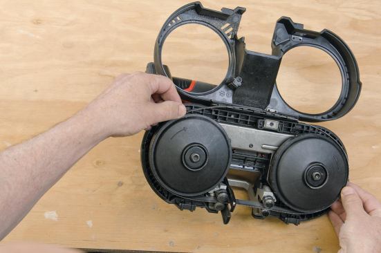

Features include a variable-speed trigger and a built-in light that shines on the cutting area. LEDs on the side of the housing indicate the level of charge. The blade tracked correctly out of the box, but if you need to adjust tracking, there’s an adjustment screw on the back of the blade housing.
Changing blades is easy: You pop the latches, open the cover, release the blade tensioning lever, and swap out the blades. After that, it’s a matter of engaging the tensioner and closing the cover.
