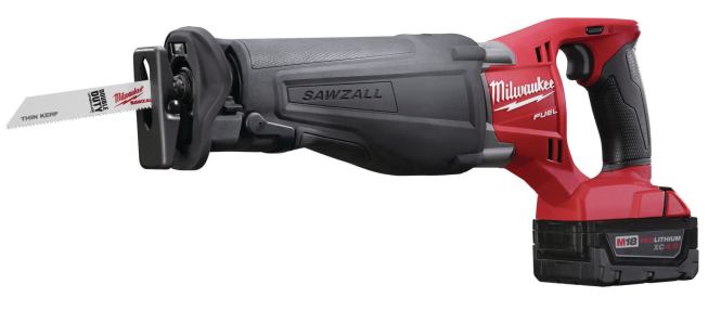

The M18 Fuel is the first cordless recip with a brushless motor. Brushless motors are more compact, efficient, and durable than standard motors with brushes. The tool has the same gear design, gear-protecting clutch, and vibration-damping counterbalance as Milwaukee’s corded 12-amp model 6519-31. Advanced electronics maintain constant speed under load while protecting against overloading, overheating, and overdischarging.

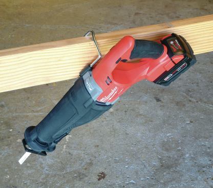

The saw also has a lever-action blade clamp for speedy swap-outs, and a quick-release adjustable shoe that makes it easy to control the maximum cutting depth or to use a fresh series of teeth to extend the life of the blade. Much-appreciated finishing touches include a pivoting hang hook and a bright LED headlight with a 10-second afterglow when you release the trigger.

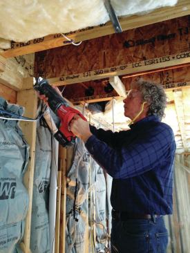

We’re too busy to conduct our own speed and runtime tests, but we’ve pushed the M18 Fuel hard for five months—cutting everything from existing framing to 1/2-inch rebar—and it’s in a league of its own. We thought we would miss the orbital cutting mode, but we don’t. The saw speeds through our cuts like a corded tool and has yet to stall or to shut itself off to prevent overloading. The 4-amp-hour battery has had ample runtime to complete each of our cutting jobs, and its built-in fuel gauge tells us when it’s time to recharge. This is helpful given that it’s not a quick charge—in one timed trial, it took us one hour and 26 minutes to fully recharge the high-capacity battery.
The saw weighs about a pound less than our corded recip, is comfortable to grip, and does a good job of taming vibrations.
