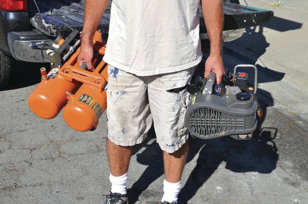

Ridgid’s new oil-free Mobil Air Tri-Stack 5-gallon compressor (model OF50150TS) separates into two parts for carrying, and it also delivers more air than my twin-stacks. When I saw it at Home Depot several months ago, I couldn’t resist buying it to see if it would be a significant step up.
Split Personality
As the name indicates, the Tri-Stack has three tanks, including a pair of two-gallon tanks on the bottom and a one-gallon tank up top that bolts to the motor. The bottom has a regulator with two outlets, and the top has a regulator with one outlet.
If you search “tri-stack” at ridgid.com and click on the link, you can view a video that demonstrates the compressor’s versatility. For starters, you can separate the top and bottom units by simply pulling and twisting a knob and releasing the connecting hose. That allows you to carry the 43-pound top section with one hand and the 34-pound bottom section with the other. You can also use the regulated top section solo for powering a finish nailer and other small loads. Used this way, the compressor kicks on after almost every shot because of the small top tank, but for some interior trim jobs, we’ve found the self-contained unit to be a convenient substitute for a pancake. Meanwhile, the bottom unit can serve as a regulated air-carry tank, but according to Ridgid you can only drive about 20 two-inch, 15-gauge finish nails into pine before you have to reconnect the top unit to refill the tanks. For small jobs, why not just use the top unit instead?
Yet another option is to separate the two units and connect them with an extension hose so you can plug the compressor directly into a receptacle (as recommended) but move the main tanks closer to the work. We’ve done this, and although it allows us to use shorter hoses, we haven’t noticed any change in line pressure.
Most of the time, though, we use the compressor conventionally and only break it down for easier carrying.
