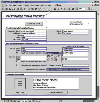

When you first open your renamed template, it should look like Figure 1.
Figure 1. The original unmodified template in Excel shows which fields need to be filled in.
To make it easier to edit the template, first turn the cell row and column headers on. Go to TOOLS, then OPTIONS, and check the “Row & column headers” box under the VIEW tab. You’ll be editing both tabs of the workbook, starting with “Customize Your Invoice.” Heading. Starting at the top of the “Customize Your Invoice” sheet, combine cells D4, E4, and F4 by clicking with the mouse while holding down the SHIFT key, and then click the MERGE CELLS icon on the formatting toolbar (or click CELLS on the FORMAT menu, go to the “Alignment” tab and select the box “Merge cells.”) Now change the cells to read CUSTOMIZE YOUR CHANGE ORDER. Continue down the sheet filling in information and changing cell information as you go. When done, your sheet should look like the one in Figure 2.
Figure 2. Once the original invoice template has been changed, you should have a change order template such as this one.
