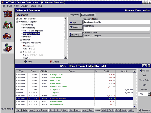

I’ve been around computers a long time, so I appreciate the value of SiteTrak’s simple and easy-to-use interface — even computer newcomers will be comfortable right away with this layout. The program is organized into four interconnected main sections, or "windows," represented by icons on the left side of the screen. All four windows share the same general layout, plus a common "Bank Account Ledger" called "Nsite" ("insight") at the bottom of the screen.
Bank
. The Bank Entry window is where you enter payments and write checks (see Figure 1).
Figure 1. The Bank window is where all checks, job payments, and other transactions are entered. Entries can be assigned to one category, such as a project or supplier, or spread or "split" across several. Categories are customizable by the user. Anyone familiar with Quicken will recognize the method of distributing bank deposits and checks across multiple jobs by "splitting" the transaction. For example, a check written to your local lumberyard at the end of the month might actually cover payments for invoices from several jobs; similarly, a single bank deposit might include payments from several projects. By breaking up these transactions, SiteTrak helps you keep track of where all the money is going.
