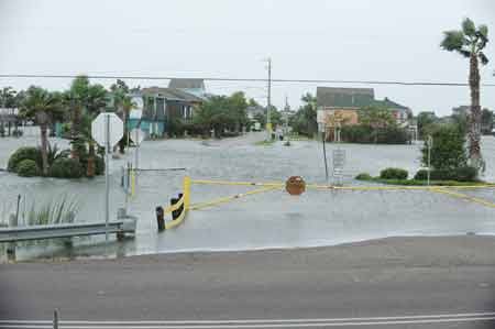

Rising water began to block roads near Galveston, Texas, far in advance of Hurricane Ike’s landfall and official storm surge. Photo courtesy Jocelyn Augustino/FEMA More than a year after Hurricane Ike made landfall near Galveston, Texas, some scientists are still puzzling over one of the storm’s unusual traits — rising water that flooded some parts of the Texas coast far in advance of the storm’s anticipated surge. “There’s something called a forerunner that isn’t showing up in any of the computer models,” North Carolina Sea Grant storm flooding expert Spencer Rogers told Coastal Connection in November. The forerunner wave appears to have caused Ike’s high water to arrive earlier, stay longer, and cause more damage than was otherwise expected. The early flooding may also have contributed to Ike’s tragic fatalities. That’s because some residents who had planned to evacuate low-lying areas ahead of the storm found their escape routes blocked much earlier than they had anticipated. Unable to make their way to safety, some of the locals became victims of the storm: trapped, swept away, and drowned when the main surge and its punishing waves did arrive. “It was actually flooded on the Bolivar Peninsula for over 20 hours,” says Rogers. “The flooding came in way early. Normally, four or five hours would be a long period for peak flooding. But that early wave flooded everything, so people couldn’t get off the island — 24 hours in advance, practically.”
