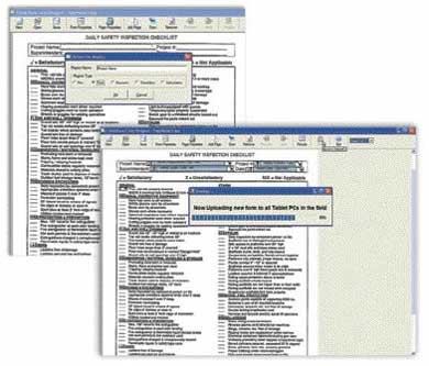

The Forms Engine is equally impressive. Back at the office, an administrator scans and uploads all your standard paper forms to the Field2Base servers using the included Form Designer application, which runs on an office PC. Change orders, purchase orders, time cards, job logs, punch lists — pretty much anything that can be scanned with an inexpensive scanner — can become part of the system.
Once tweaked and uploaded, digital forms look exactly like the paper originals, and they’re instantly available to users in the field from a simple menu on their tablet PCs. They’re simply filled in electronically using the tablet PC pen. The Forms Engine enhances the tablet PC’s built-in handwriting recognition by assigning areas of the forms as Numeric, Calculating, Checkbox, or Text. That way, the system doesn’t mistake a zero for the letter “O.” Once filled in, a digital document can be wirelessly e-mailed or faxed to an individual or group. Digital documents sent and received by the system are all logged, so it’s easy to re-create a paper trail.
