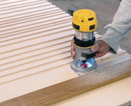

The one-horse and 1-1/4-horse compacts seem like two separate categories, because the latter are noticeably more powerful. My overall favorite is the variable-speed 1-1/4-horse DeWalt. It delivers strong, even power at various speeds; offers a fixed and a plunge base that are both first rate; has dual LED work lights and clear sub-bases for excellent visibility; and provides a full range of optional attachments.
