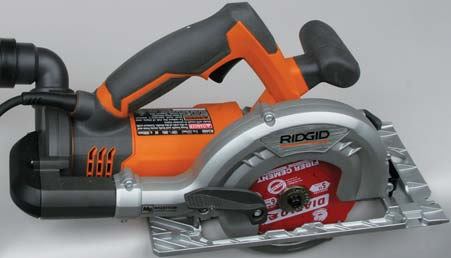

Last fall I reviewed several saws that collect the dust generated when fiber cement is cut. More recently, I tried out a new contender in this category: Ridgid’s R3400. Unlike other dust-collecting saws, this machine doesn’t rely on a vac. Instead, it contains a fan that pulls dust out of the blade housing and sends it through an 8-foot hose into a covered drywall bucket. It’s a very clever design.

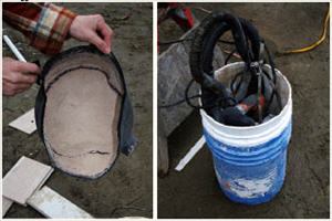

It’s also very efficient. Only a small amount of dust escapes from the cut and almost none from the filter. Working without a vac is great because you have one less tool to haul around and supply power to. Also, the collection bucket is smaller and lighter than a vac — you can tuck it under the worktable and, when you’re working off staging, hang it out of the way. At the end of the day you can empty the bucket and store the filter, clamp, saw, and hose inside.
According to Ridgid, you should clean the filter after every 100 cuts by taking it off the bucket and sucking the dust out of it with a HEPA vac. We made at least that many cuts without clogging the filter — though we did notice a decrease in collection efficiency. We cleaned the filter by shaking it into the dumpster.

Fixed depth-of-cut. The R3400’s base can be tilted up to 45 degrees, but oddly enough it can’t be adjusted up or down. This fixed depth-of-cut means you can’t cut single pieces without the blade going deep into the cut table.
To keep from destroying the table during cross-cuts, I elevate the stock on a series of blocks. If I need to rip a single piece, I position the cut line so that the blade comes through off the edge of the blocks or table.
Performance
The saw comes with a six-tooth fiber-cement blade and cuts single pieces of siding like butter. But to gang-cut, you have to slow down a little. The view to the blade is unobstructed, making it easy to see your cut line. I normally use a wormdrive, so it took me about a day to get used to the blade-right configuration of this machine.
