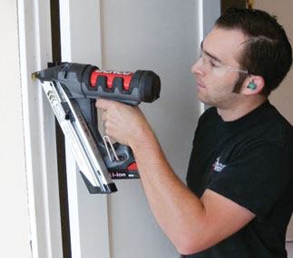

When I heard that Senco was introducing a new cordless finish nailer, I was both excited and skeptical — excited because I dislike using hoses, and skeptical because as a long-time user of cordless finish guns I am aware of their shortcomings. This new gun is the first in a family of tools called Fusion, and Senco claims that it will do away with most of the problems associated with cordless guns.
For the last few months I have been using the 15-gauge model, the FN65DA. An 18-gauge Fusion, the FN55AZ, is scheduled to be released around the time this story is published, and Senco says that other models are in the works.
Senco FN65DA

A third way. The Fusion gun uses a battery-powered motor to compress nitrogen gas in a sealed cylinder by lifting a piston against it. Squeezing the trigger releases the piston, allowing the compressed gas to propel the driver into the nail — same as in a pneumatic tool. As soon as the nail is driven, the motor retracts the driver, which recompresses the nitrogen. The entire cycle takes a fraction of a second.
Using the Gun
According to Senco, the Fusion combines the power and feel of a pneumatic nailer with the convenience of a cordless tool. I agree: When you shoot this gun it has the instantaneous pop of a pneumatic nailer — but without the blast of air at the end of the cycle. The nitrogen is sealed inside the drive cylinder and gets used over and over, like the gas in an air-shock or door lifter. The tool is quieter than a gas nailer, but I still wear ear protection.
We used the Fusion to drive fasteners up to 2 1/2 inches long in plywood, poplar, cherry, MDF, pine, and Douglas fir framing material. There was no issue with power — it drove as well as our pneumatics.
The 15-gauge Fusion is very well-balanced, so even though it’s heavier than a gas finish nailer, using it is not a hardship. A rubberized grip and body make the gun comfortable to hold and protect the surfaces it’s placed on. Most nailers will only lie on their sides, but this one can be placed upright on the magazine, making it easy to grab and go.
Firing modes. The gun has a dry-fire lockout that prevents it from firing when empty and putting unnecessary holes in the material. A three-position switch on the side of the housing allows the user to turn the tool on or off and set it to single-shot or bump-fire mode. I use the single-shot mode for finish work; it forces me to be deliberate about fastener placement, so I don’t overnail the trim. The only time I use bump-fire is for fastening blocking. The gun is capable of driving about one nail per second, which is more than enough speed for finish carpentry.
