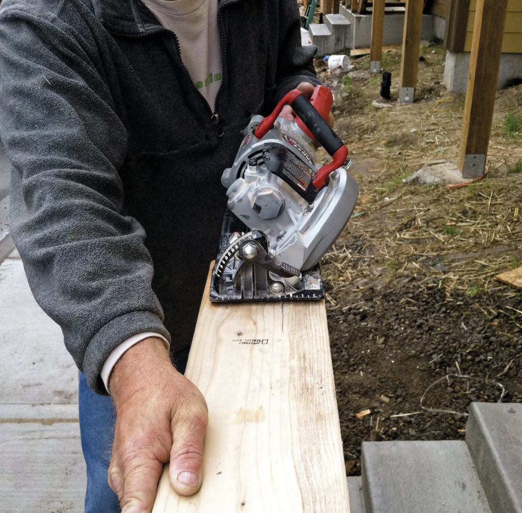

At first glance, the MAG77LT doesn’t look radically different from other Skil wormdrives. But Skil micromanaged the design inside and out to shed some weight while adding welcome features.
To subtract weight, Skil used magnesium for the blade guards and baseplate, reduced the length of the motor by 3/8 inch, reshaped the motor housing so it’s cylindrical and is attached with shorter screws, moved the spindle lock from the front to the side of the gearbox and combined it with the oil plug, and even refined the rafter-hook mount.
I appreciated the lighter weight as soon as I lifted the saw, and the benefit was multiplied after using the tool all day or cutting overhead, such as when trimming rafter tails from a ladder. In my opinion, that alone is a game-changer.
Skil increased the no-load cutting speed from 4,600 to 5,300 rpm, so the saw should cut a bit faster. I didn’t drag-race this model against my other Skils, but after cutting just about everything framers will normally cut with it (including plenty of LVL), I can’t tell the difference.
Other Upgrades
The saw I tried cut perfectly square at the 0-degree setting, but if it ever veers off, it can be corrected by adjusting a screw on the baseplate. It bevels to 53 degrees (compared with 51 degrees for the SHD77 and MAG77), and the bold new bevel scale has white markings against a black background for a much easier read. The “Cut-Ready” depth bracket has practical scales that make it faster and easier to set the correct depth for cutting lumber and sheet goods. The new soft-grip rear handle is also an improvement.
I especially like the tool’s unique multi-function wrench, which lives on the baseplate so it’s always within reach. It’s a blade wrench, plus it can pry the diamond knockout out of a new saw blade, loosen an over-tightened bevel or depth lever, and remove and install the oil plug and brush caps.
