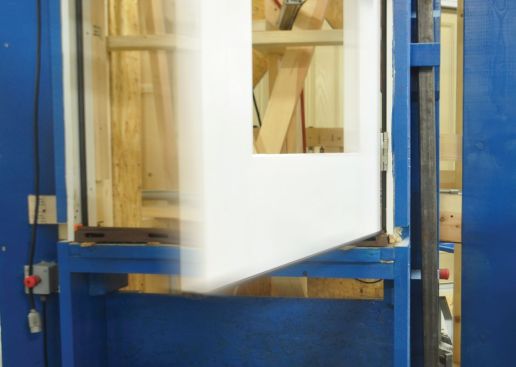

1. Open and Shut
First, it’s open and shut. Literally, the door is opened and shut 50,000 times to make sure that weather stripping and other parts that compress or engage as part of door operation perform reliably throughout the life of the door unit. For door locks, add an additional 50,000 repetitions for a total of 100,000 cycles of operation.
Open Shut Test
Open Shut Test

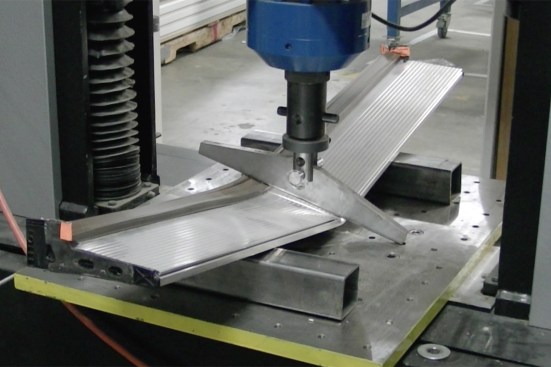

2. Endurance
Any door unit must face extremes in heat and cold, as well as humid and salty air so that wherever in the US or Canada the door unit is installed, it will provide a lifetime of use with no surprises. Weight slams into the door and is fired at the door as demonstrated in this door cannon video. Testers drag weights across thresholds to make certain that door sills can stand up to the stress of moving furniture. All this simulated force is applied so that parts don’t fail, even when they are not used as intended.
INSTRON Force Test
INSTRON Force Test

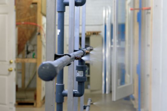

3. Water and Air
Finally comes water and air testing – typically referred to as wind-driven rain in the testing business. Doors are subjected to ever increasing wind and water for hours at a time to prove that they can keep air and water out.
Water Test
Water Test
