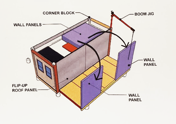

One in particular was from Mesocore, which has engineered a clever ADU that it calls an Advanced Dwelling Unit and describes as “a hybrid construction system with a steel core and all the home’s electric, solar and plumbing.” It’s delivered to the site as a 20-foot container (see photos, below), and the company claims that it remains a permanent structure built on a slab or on concrete piers or helical “screw” piles. Once on site, the “core” expands on both sides to a 420-square-foot ADU with bedroom, 5-by-8-foot bath, kitchenette, and 7.5-square-foot closet. With the included frosted glass sliding doors, the living and sleeping spaces can be completely cordoned off.
More interestingly, the company claims the unit can be completely assembled and livable in five days. Scanning over the remarkably clear five-day schedule/assembly instructions, I’m inclined to believe it, since the steel-cage core comes stuffed with every component you’ll need to complete the assembly. That includes a small manually controlled crane (“boom jig” in illustration, below) to move wall and floor panels into position from being stored on the innovative roof, which doubles as a cistern storing rainwater and feeding into a gray-water system.
