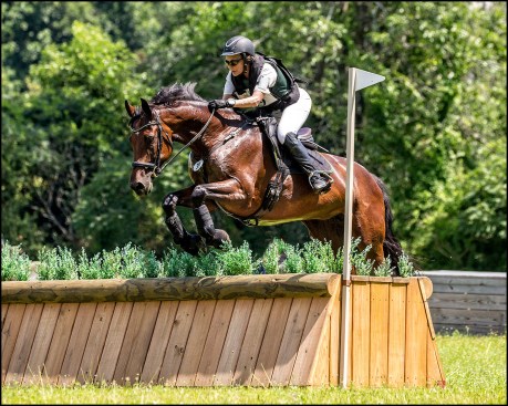

A paired horse and rider team jumps a cross-country jump built by the author. (Special thanks to Joan Davis of Flatlandsfoto for eventing photography.)

Portable jumps. The biggest part of my business as an equestrian contractor is building the cross-country jumps used in eventing competitions. There are two types of cross-country jumps, permanent and portable. Permanent jumps feature items such as lined ponds, ditches, and fixed structures (typically log posts set into the ground with a horizontal log strapped to them). Portable jumps vary from 24 to 42 inches high by 8 to 16 feet long and are moved around with tractors.
Built to withstand a blow from a jumping horse and to live outside year round, portable jumps are made out of durable materials such as pressure-treated wood, common residential siding products, and with increasing frequency, synthetic trim and roofing—cellular PVC and faux slate and shakes.

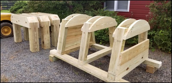

I construct the jumps out of heavy-duty ribs made from 2-by and 4-by pressure-treated stock attached to 4×6 skids (two long pieces of pressure-treated wood that are essentially the foundation of the jump). I use a mixture of screws, metal clips, plates, and ties from FastenMaster and Simpson Strong-Tie to tie everything together before I sheathe the structure.

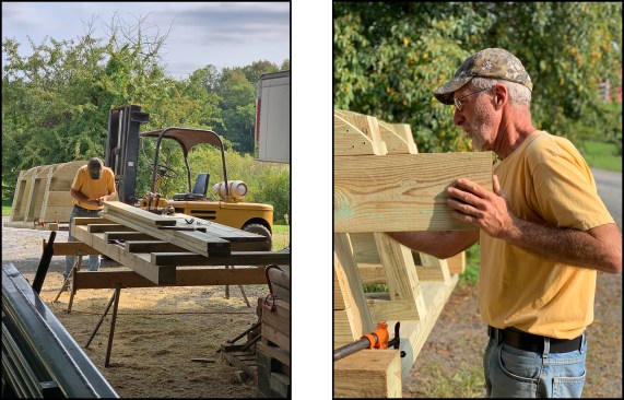

Cross-country jumps are typically built on 6-by pressure-treated skids, which serve as the jump’s foundation (left). These “portable” jumps are moved around using tractors (lifted up by the skids with forklift attachments). Here, the author assembles a jump’s beefy ribs made from 2-by and 4-by pressure-treated stock (right).

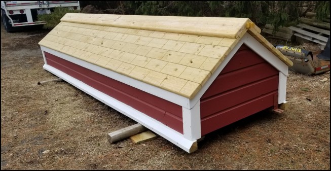

Keeping up to date. I make it a point to attend JLC Live yearly to visit manufacturer’s booths, on the lookout for new connection hardware and fasteners as well as new, durable building materials I can use to highlight my jumps. I recently completed a barn structure using Versatex PVC trim. I routed grooves in the pressure-treated 2×6 roofing to simulate three-tab shingles, prior to applying a stain finish.
A recently completed a barn-style jump.

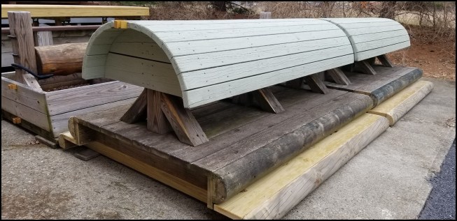

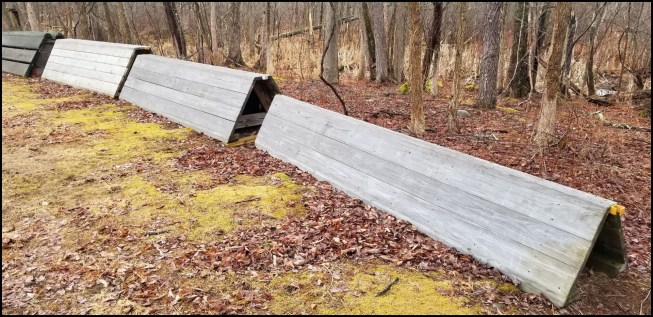

Trapezoidal-shaped “coop” jumps are commonly used in eventing. Jumps are often stored outside, so they have to be built out of durable materials.
Chris Milanesi

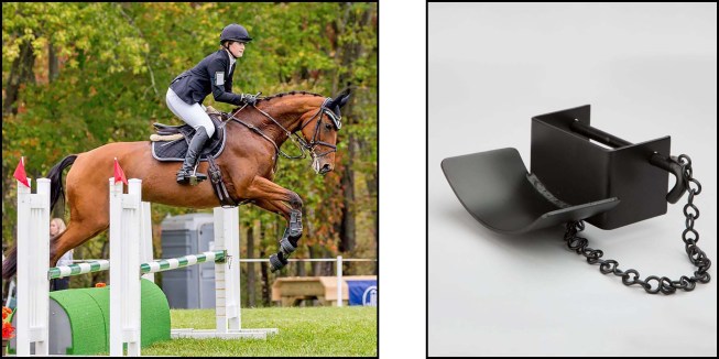

Show jumps or stadium jumps have painted rails (left) set in metal jump cups, which allow the rails to break away easily if clipped by a horse (right). The metal jump cups allow for height adjustability on wing stands on either side of the rails.
Left, Joan Davis, Flatlandsfoto; right, Burlingham Sports
