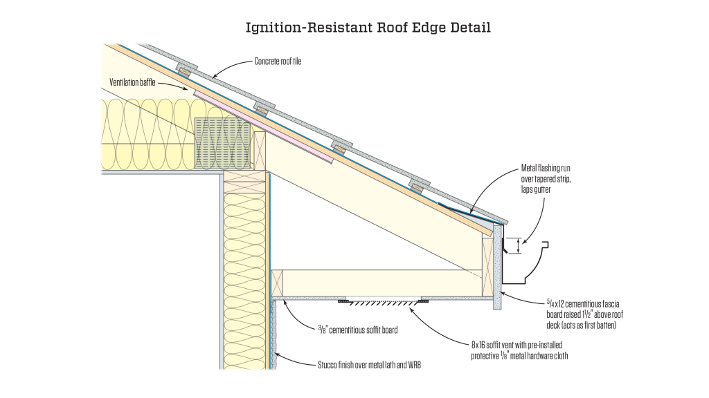

Section 504.10 of the IWUIC states that mesh openings should not exceed 1⁄8 inch, as shown in the illustration above. The author recommends 1⁄16-inch mesh. Check with your local building code for what applies in your area.
Q. During wildfires, burning material travels in the air long distances and starts fires along the way. For a home I am building in a forested area, how do I prevent hot embers from being drawn into the attic through the soffit and eaves?
Getting back to the question, the hot air carrying the embers is going to try to find cooler air, and high pressure is going to try to find low pressure. So, the outside air will try to push its way into the house’s vents. The solution is install a noncombustible, noncorrosive metal mesh on the inside of the vents. The mesh acts as backup for the vent to catch the embers and prevent them from entering the home. Requirements for mesh size vary by state and even locality. The international code requires ¼- to ⅛-inch mesh, but I recommend ⅟₁₆ inch, which is what the California building code calls for.
While installing mesh would help prevent the embers from entering the attic space, the builder should look at the rest of the home too. If the accepted 5-foot perimeter around the home is not clear of combustible material, like mulch, or if the siding and roof are not fire resistant, the mesh will be of little use.
