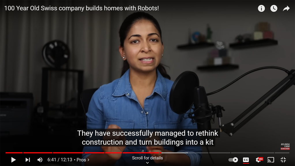

One hopeful change-maker she reports on is Renggli, a Swiss modular home builder. Her review is inspiringly positive, but Carr doesn’t have to go all the way to Switzerland to find similar examples. Companies like Unity Homes by Tedd Benson in New Hampshire and Plant Prefab by Steve Glenn in California show the enormous potential of building high-quality, ultra-efficient prefab homes. Will such solutions render stick building obsolete? Not for a long while yet. Off-site construction methods (including modular, prefab, and panelization) account for only 2.4% of the 970,000 new homes constructed in 2021, according to U.S. census figures (see "Construction Method" XLS tables here). Off-site building techniques make sense only in dense housing markets where the cost to build a state-of-the-art house factory can be rationalized across a short distance. But the U.S. is an immense country. Switzerland is about half the size of Maine. Sixteen Switzerlands would fit in Texas. The cost (and carbon) of transporting massive building components over long distances begs the question: How many factories do we need to build before we “fix” construction across the entire U.S.? Real answers, Carr helps me realize, are not going to be found solely from tech solutions.
