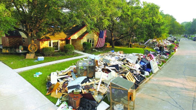

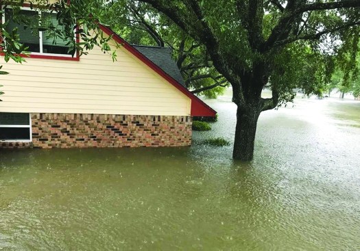

When Hurricane Harvey brought 5 feet of floodwater to my neighborhood in Friendswood, Texas, my family and I faced a choice. Like all of our neighbors’ houses, our 1970s-era ranch house was badly damaged. What should we do? Should we repair the house sitting at grade where it stood? Should we elevate the existing house on a new foundation? Or should we tear the whole place down and start over?

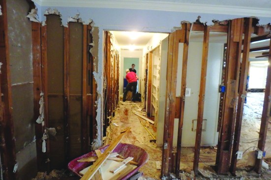

But those decisions would have to wait, because after any flood, the first thing they tell you to do is clean up. Partly that’s for health reasons: There’s going to be a parade of insurance folks and government folks marching through to evaluate things, and the house can’t be full of rotted junk. And for insurance reasons, you need to clear out everything that’s damaged, make lists, and take plenty of photos to document your losses.
If you let everything sit there waiting for someone to make a decision, insurance policies typically won’t cover the increased damage that will result if mold takes over the entire house. Flood insurance coverage usually applies only to the immediate effects of the water, not to things that happen later.
So as soon as the water went down and we could go back to the house, we gutted the walls and put all the debris out at the curb. And then sure enough, along came the insurance people, FEMA, the Small Business Administration (SBA), and all the other federal and local agencies to see what was going on.
Up to the eyebrows. The author’s house, which backs onto a creek in Friendswood, Texas, flooded 5 feet deep in Hurricane Harvey.

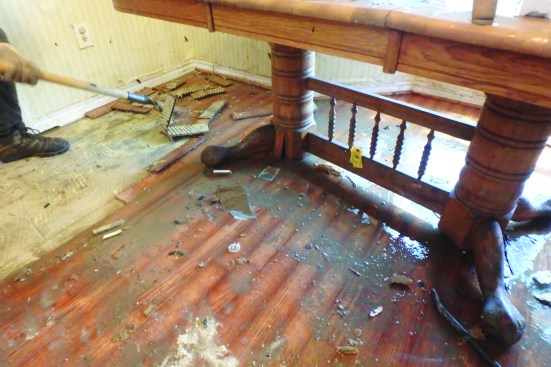

All the interior materials and finishes were ruined, including the wood flooring shown here.

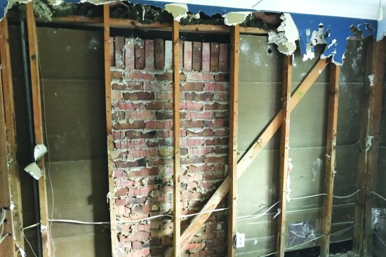

Cleanup. The first priority in any flood is to clean up, in order to minimize health risks and prevent ongoing damage from mold and rot. The author’s family and friends gutted out all the walls.
Outdated structural details were revealed such as gypsum sheathing and diagonal bracing.

All the debris was dumped at the curb.

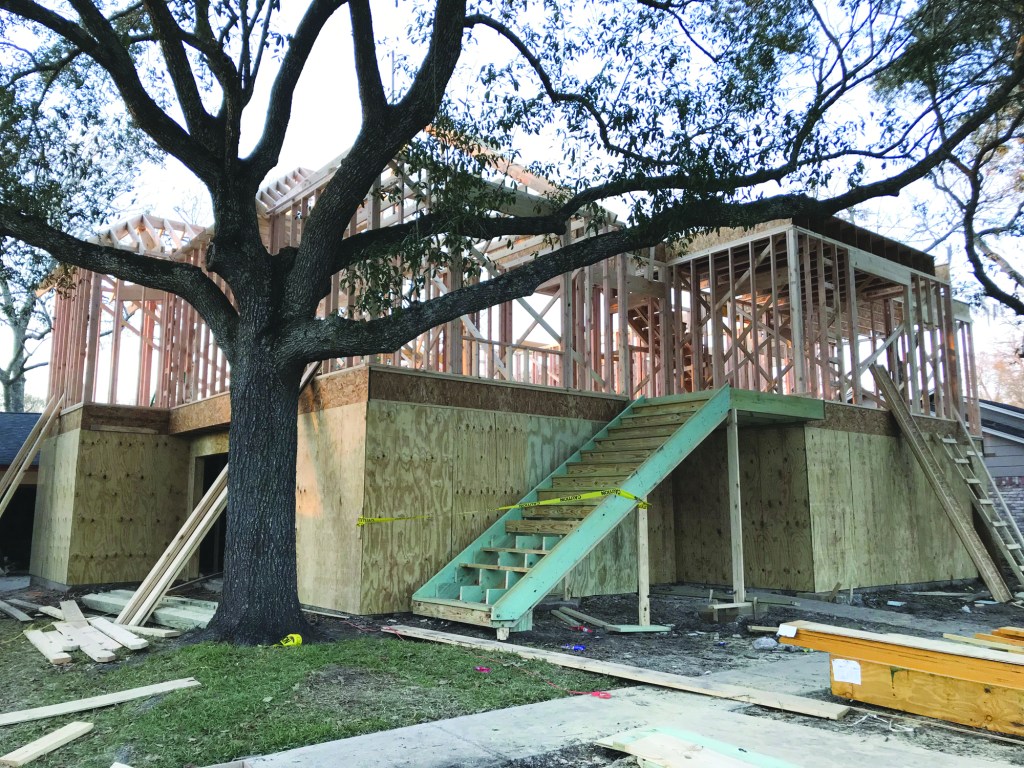

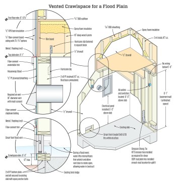

The author coined the term “Texas basement” for this 8-foot-tall space, with room for storage, that is detailed like a crawlspace with flood vents at the wall base, ventilation openings near the ceiling, and shear-wall details engineered to handle the uplift and lateral forces of 120-mph hurricane-force winds.
Tim Healey
After considering all that, we decided to re-use the existing slab—which saved us about $50,000 compared with the cost of demolishing the slab and building a new foundation to replace it.

When I started to ask questions at the building department, I learned that a new house at this location would need to have the lowest framing member for its first occupied floor situated 2 feet above base flood elevation (BFE). When I had our existing slab surveyed, we found out that the slab sits 6 inches below the BFE. So if I built our new house on a crawlspace, that crawlspace would need to be at least 2 1/2 feet high.
I said to the flood-plain manager, “Well, we flooded 5 feet deep in Harvey. If we duplicate Harvey, and I’ve built 2 1/2 feet high, we’ll just flood again.”
Besides that, I’m 6 feet tall, and I wanted to be able to use my crawlspace for storage and such, not crawl around it on my stomach. The flood-plain manager told me that I could build higher than 2 1/2 feet if I wanted to; but he could only require me to build 2 1/2 feet high.
Well, studs are 8 feet long, and so is plywood. And considering that we had already experienced 5 feet of flood­water, I decided that if I had to go up anyway, I would go up 8 full feet and have a full one-story space that I could stand up in and use. Technically, it’s still a crawlspace, and it would still have to be detailed as a crawlspace: unoccupied, with flood vents and air vents. But I began to call it my “Texas basement.”
The Texas Basement

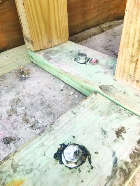

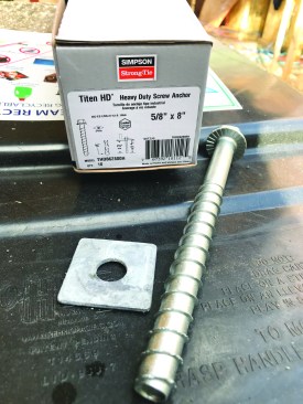

The demo company used Bobcats to scrape the slab, and in the process, they either cut off or bent over all the existing anchor bolts. So we had to replace all of those, using Titen HD bolts from Simpson Strong-Tie. The engineer called for 1/2-inch bolts 6 inches long, set at 32 inches on-center, but all my supplier had were 5/8-inch bolts 8 inches long. My engineer was fine with that change—and at the same price for a much beefier connection, so was I. Our guys did wear out a few drill bits putting those bolts in, though—40-year-old concrete is hard.
The author secured the crawlspace wall sole plates to the existing foundation.

He used Titen HD structural bolts from Simpson Strong-Tie.

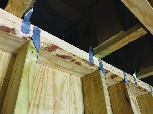

Besides being in a flood plain, we’re also in a hurricane exposure area with a 120-mph design wind speed. So the anchor bolts are just the lowest element in a wind-resisting load path that goes all the way up to the ridge. All the exterior walls, as well as some of the interior partitions in the crawlspace, are detailed as shear walls, with 1/2-inch treated plywood on the treated studs, nailed with galvanized nails at 4 inches on-center in every stud. Some of the interior shear walls go right up through the upper-story partitions all the way up to the ridge. We used Simpson HTT5 hold-downs at the ends of the shear-wall panels, and Simpson SSP stud plate ties to tie studs to the sole plate at the foundation, and Simpson H-2.5A hurricane ties at the top of the wall to tie the studs to the wall plates.

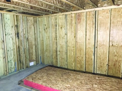

The space’s 8-foot walls are detailed as shear walls for windstorm resistance, including 4-inch-o.c. nailing and beefy hold-downs.
We used treated wood (UC3B, which is rated for above-ground use, but not rated for ground contact) for the entire crawlspace wall system. All the plates are treated, all the studs are treated, and all the posts are treated. The lowest untreated piece of wood is the top plate of the 8-foot lower wall.
Technically, I could have used treated wood for just the part of the structure that lies at or below the BFE. I’ve seen some buildings on which they’ve done just that: used an 18-inch-wide strip of treated plywood at the bottom of the wall. But treated plywood is only a few bucks more a sheet, so we framed and sheathed all the way up the “crawlspace” wall with treated studs and plywood. To make sure the framers didn’t accidentally mix in any untreated wood, we didn’t have anything but treated wood shipped to the site until our Texas basement walls were all framed.

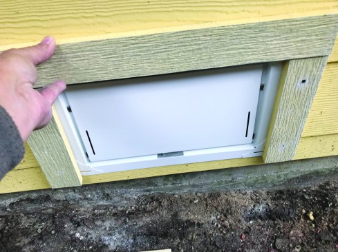

Flood vents operate automatically to relieve water pressure in case of a flood.
We installed about a dozen Smart Vent flood vents, strategically placed around the base of the walls. For aesthetic reasons, we placed them all on the side and back walls; but then again, the back of the house is where the creek is. Smart Vent provided engineering services to spec out the vents. They were easy to install because they’re sized to fit neatly between two studs at 16 inches on-center. We just blocked in for them and installed the siding right over the opening. Then we cut the siding out with a recip saw and popped in the vents, adding a little trim for looks.

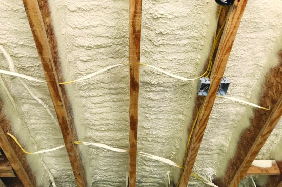

Closed-cell spray foam defines the thermal boundary of the first occupied floor.

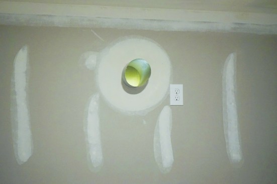

At the top of the wall, 8-inch round ducts provide the required ventilation. These are also spread around the walls to allow cross-ventilation and are screened to keep the bugs out. On a hot day, the space under the house seems to stay about 10°F cooler than the outdoors.

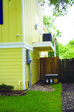

The “Texas basement” has ceiling lights and wall switches and outlets, but the electrical panel for the space is located 5 feet above the floor, and the outlets and switches are 6 feet up. I’ve installed shelving at 5 or 6 feet high as well, to keep our belongings dry if it floods. We also lifted the air-conditioning equipment up almost 10 feet, to be above any future floodwaters.
Power and mechanicals are elevated above the level of the Harvey floodwaters.
