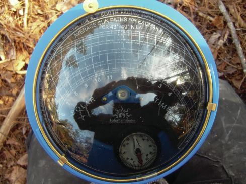

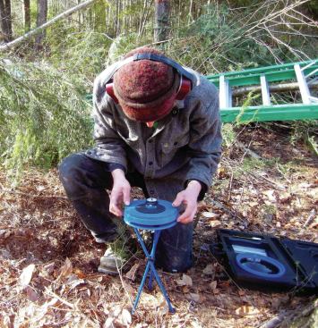

The next step is to analyze the site's shading conditions. Harvesting heat from the sun is serious business in a Passive House, so accuracy in the shading analysis is key. Passive Houses in northern climates are often forced to rely heavily on solar gain through south-facing windows. For complex shading conditions, such as in mountainous or forested locations, I use a Solar Pathfinder—a clear plastic dome that projects shading objects from the site onto a sun path chart. Shading percentages are tallied and entered into the PHPP.
Our building site was forested with a large hill to the southeast. After a fair number of trees were cleared, the pathfinder showed good solar-gain potential.

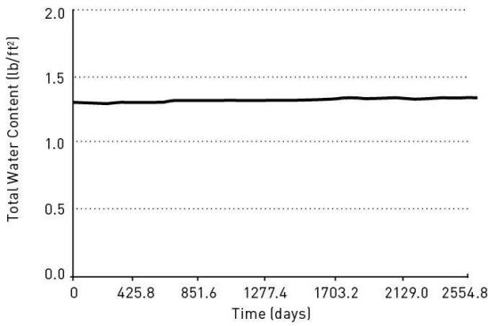

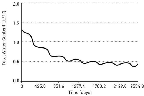

Before building assemblies are finalized, they must be analyzed for moisture and mold risk. Potential for moisture issues in high-performance building assemblies can be greater than in conventional buildings. I use the program WUFI-ORNL/IBP for this analysis because it's free and is suitable for most non-commercial construction.
In our project, the roof design required special attention for possible moisture risk. When I modeled the proposed unvented dense-pack-cellulose roof with a variety of vapor retarders, WUFI-ORNL predicted in each case that the assembly would not be able to dry. As a result, the moisture content would slowly rise over the seven-year period that I analyzed. When I compared this assembly to a back-vented assembly, the results were dramatic. With 1 ACH in the venting plane, the roof assembly showed a significant, 66% drop in moisture content over the seven-year period. Based on these results, I recommended a ventilation plane.

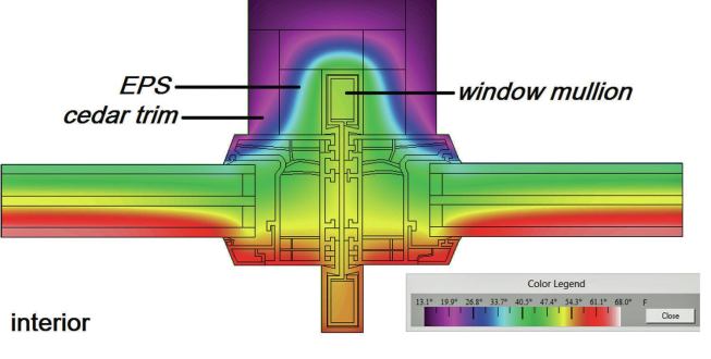

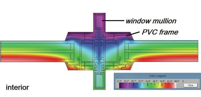

Thermal bridges that can't be eliminated need to be modeled separately in two-dimensional heat transfer programs such as THERM, which is a computer program developed by the Lawrence Berkley National Lab to help window manufacturers to accurately determine window performance for NFRC ratings. The PHPP can calculate heat transfer only from point A (inside surface of assembly) to point B (outside surface of assembly), while a program like THERM can calculate the additional thermal transfer that occurs when materials with significantly different R-value interact with each other within the assembly. Areas that typically could benefit from a THERM analysis are window installation details, foundation footing details, and band-joist details.
Our biggest thermal bridge concern was the window connection mullions. To determine if they were a thermal bridge, I first drew them in THERM. (THERM runs a heat-transfer simulation with a mullion and then without one; the difference represents the contribution of the mullion. My THERM analysis of the mullion showed that it was a condensation risk and impacted our heat demand. I used THERM again to determine that wrapping the outside of the mullion with a strip of 1 1/4-inch EPS insulation would eliminate this thermal bridge.
