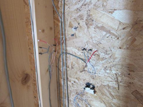

Last summer, JLC reported on research by Kohta Ueno of Building Science Corp. (BSC) into moisture accumulation in double-stud walls (see “Studying Moisture in Fat Walls,” Jun/14). Ueno had planted moisture meters on the sheathing of a 12-inch-thick stud wall in a zero-energy house in Devens, Mass., built by Transformations Inc.

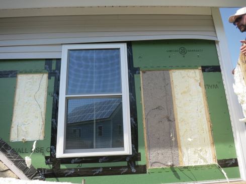

Transformations’ standard wall system, in place in dozens of homes in a Devens development, is a 12-inch double-stud wall sheathed with Huber Zip sheathing and insulated with medium-density open-cell polyurethane foam, spray-applied in the field. But Carter Scott, Transformations’ president, wanted to know if dense-pack cellulose insulation, which might be more economical, would work as well. So the researchers put instruments into walls—on the north and south sides of one of Scott’s homes—with three different insulation strategies: 12 inches of dense-blown cellulose; 12 inches of medium-density open-cell spray foam; and 6 inches of the open-cell foam.

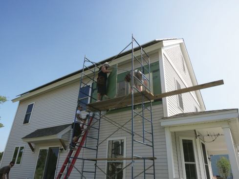

Mold and rot require both heat and moisture to grow. In the winter the walls may be wet, but there’s not enough warmth for mold to thrive. In the spring the walls get warmer, but over the course of the season they dry out to the point where there’s not enough water to support the mold. So the critical question for wall durability was whether the walls were warm enough and wet enough at the same time—and for long enough—to allow fungus to get a foothold and damage the building. To find out for sure, Ueno and his team decided to cut the test walls open and inspect the sheathing.

In a report posted on the BSC website (buildingscience.com), Ueno writes: “Under high interior humidity loading (nonfunctional ventilation system, 40% to 50% interior relative humidity), all test walls showed moisture contents and sheathing-insulation-interface relative humidities well into the high risk range. The cellulose walls showed particularly high moisture contents (sheathing in excess of 30%), while the open-cell spray-foam walls showed moisture contents in the 18% to 25% range. In addition, the monitoring showed evidence of liquid water condensation (which can result in quick degradation) in all walls, and the condensation was substantial in the cellulose walls. These condensation issues occurred on the north and south sides.”
But when Ueno and his colleagues cut the test walls open to examine the sheathing after three seasons of monitoring, the results were surprising.

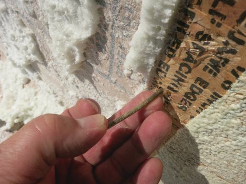

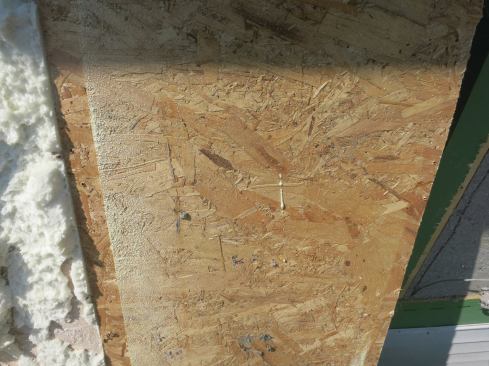

Says the BSC report: “Based on the data, calculations, and analysis, all three walls should be at high risk of failure; the analytic tools used indicate that these walls should have failed. However, disassembly showed that the walls were essentially undamaged by the monitored moisture exposure. This suggests that the walls, at least in the configurations tested, were far more robust than current analysis tools would indicate.”
“All the instrumentation and monitoring said that these walls got hammered in terms of moisture content, relative humidity, condensation, anything like that,” Ueno told JLC in a phone interview. “And the current analysis tools in the toolbox say this wall should be toast. But we opened it up and it was like, ‘Huh. Well, there’s a little bit of grain raise. The fasteners are a little bit rusty. That’s about it.’”

In the case of the cellulose-insulated walls, the borate treatment in the cellulose may deserve partial credit (borates in cellulose function as a preservative as well as a fire retardant). Writes Ueno, “In the product installed at this site, the cellulose insulation contains 15% or less (by weight) boric acid and sodium tetraborate pentahydrate; other cellulose insulation manufacturers use ammonium sulfate in this role in conjunction with borates. Previous field observations have provided evidence that these preservatives can migrate into adjacent materials (e.g., sheathing or gypsum board), thus providing them with some protection.”
“What the cellulose guys say, and what I’ve seen too, is that cellulose does a nice job of protecting whatever it’s in contact with,” Ueno told JLC. “I know that the cellulose guys sometimes over-sell it, but the bottom line is, there is a lot of truth to that.”
