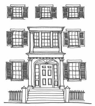

Offset Two-Story Expanded Footprint Bay
The two-story rectangular bay below adds considerable floor space and daylight to the interior without overwhelming the exterior elevation. The roof skirt between the first and second floor relates nicely to the bracketed entry roof overhang; without the skirt, the bay might have seemed towering. The flat roof keeps the bay from visually interfering with the triangular pediment suggested by the eaves returns and is stylistically appropriate for this Greek Revival hybrid.
