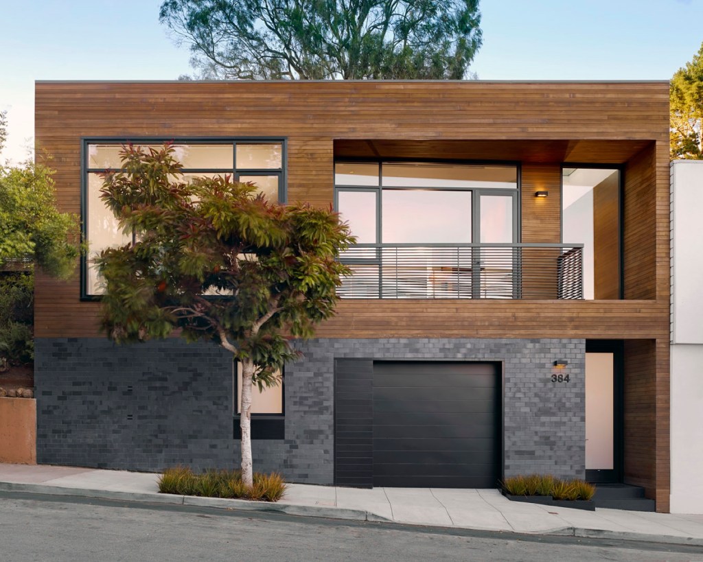

Two design ideas resonated with the judges when it came to this project—its sense of cohesion and its engagement with the surrounding property. “It’s so difficult to take a structure and have it become a cohesive voice of something new. You’re always fighting other things to … have a singular vision,” they said. “The [original] house didn’t seem to acknowledge the slope. The new one acknowledges and emphasizes the hill.” That’s the essence of why this small San Francisco home is the 2015 Project of the Year award winner.
The 1930s stucco bungalow “had no particular character,” says architect Cary Bernstein, who was asked to expand the 1,100-square foot house within its compact footprint.
To keep within the clients’ budget and the urban neighborhood’s scale, Bernstein chose not to go up but rather to find space by pushing the house out to the side property lines and 7 feet back in the rear. Contractor Felix Chan, owner of Lara Construction, demolished the house to the first floor and then reframed it from there.

The original house was living space over a garage with an external staircase. Bernstein kept that configuration but captured the stairs inside. Doing this, she says, “helped to add a sense of spaciousness in the living room because it added air and volume without changing the footprint.”
Gaining space in the back meant the team would have to create a retaining wall close to the kitchen windows  because the hill is so steep. Bernstein’s solution: a step up within the house, which helps mitigate the retaining wall and give spatial configuration to the open floor plan. The step also “contributes to the idea of this project,” Bernstein says. “You’re always traversing the hill on the inside and outside of the house. It has a practical and a metaphorical purpose, which is the way we like to view our architecture.”
The house, now 1,800 square feet, is still modest. To increase the feeling of spaciousness, Bernstein raised the ceiling from 8 to 10 feet and specified large windows, five skylights and three clerestory windows. “Almost every room has two sources of light, which makes the smaller spaces feel larger because they’re ‘active’ with changes in daylight,” she says.
