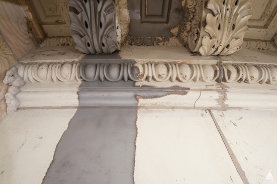

  • 12: Approximately how many layers of paint will be removed.
  • 1 year: About long it will take to remove all the lead paint from the Dome’s exterior.

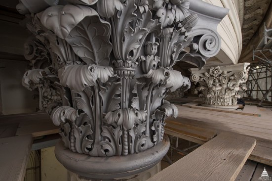

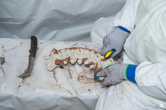

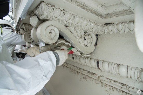

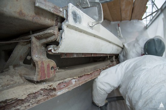

About the Process

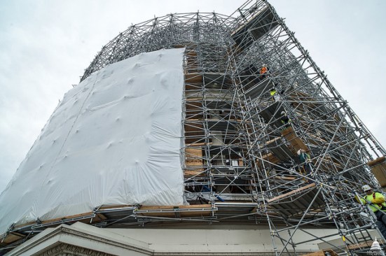

  • Containments built around the Dome are maintained at negative air during paint removal.
  • The licensed and trained workers use supplied air respirators and protective equipment.
  • Paint is stripped using abrasive blasting.
  • The spent blast media and removed paint is vacuumed inside the negative air containment, and sent through large hoses to collection equipment within the laydown area on the ground where it is placed in containers for transportation.
  • Steel barrels, approved by the District Department of Transportation to contain the waste, will be transported off site and the material will be shipped by a licensed waste transporter to licensed disposal sites.
