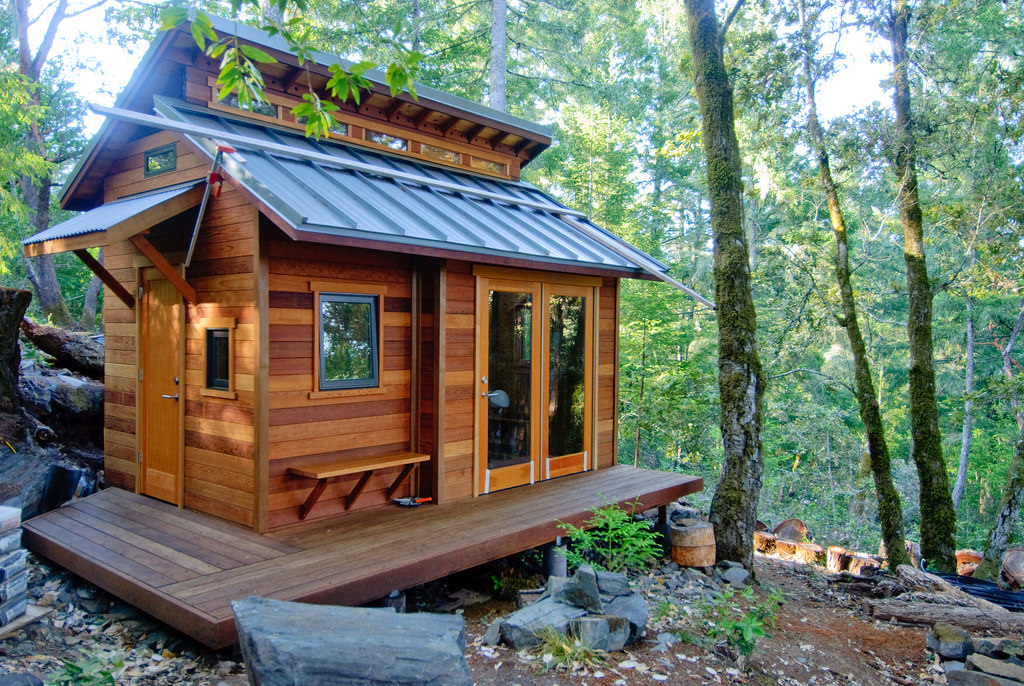

Nontraditional homes like tiny houses and log cabins can be great because they offer advantages that a traditional home doesn’t, and homeowners can adapt them to the way they want to live. But they also come with their own challenges that some would call disadvantages. As an experienced remodeler, you can turn these challenges into solved problems for your clients simply by knowing what to expect.
Build Small, Think Big
Accompanying an urge to downsize and live more simply (and affordably!), tiny houses are growing in popularity across the country. Whether it’s a client who wants to turn a former accessory space, like a large shed or detached garage into their new dream home or a homeowner who has purchased a bare-bones tiny home and needs help sprucing it up, here’s what to expect if you take a job in one of these small spaces.
